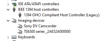

    smrpix, thank you for your reply. All the cable special adapters are all Apple, bought on Amazon as guaranteed APPLE. The cables are all the ones that are shown in in the overview you thoughtfully included which is excellent. I also have device manager showing Thunderbolt (TM) Controller 15E8. Under IEEE Host Controllers, LSI 1394 OHCI Host Controller is listed. So, I am still dead in the water, suggestions?

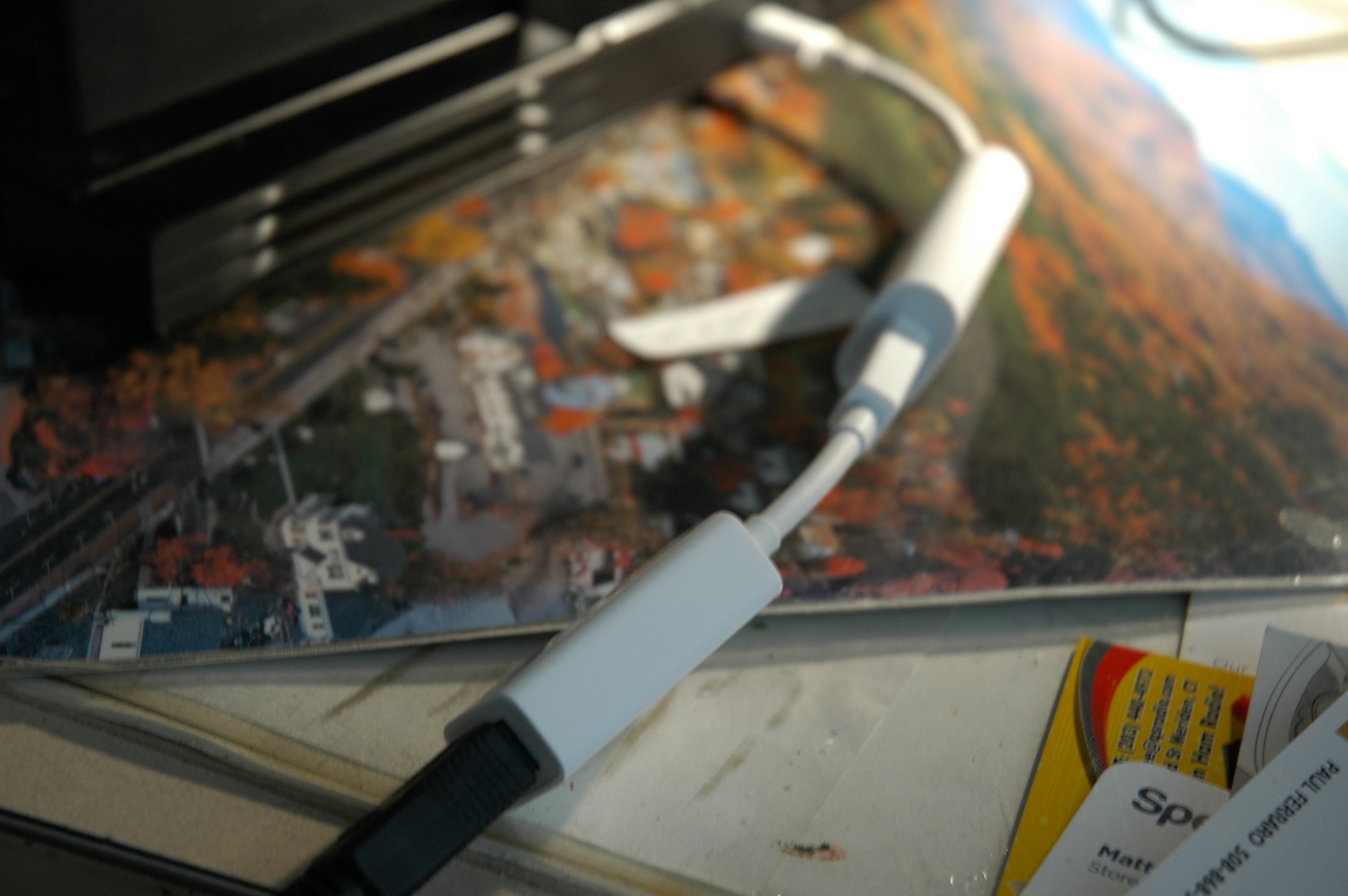

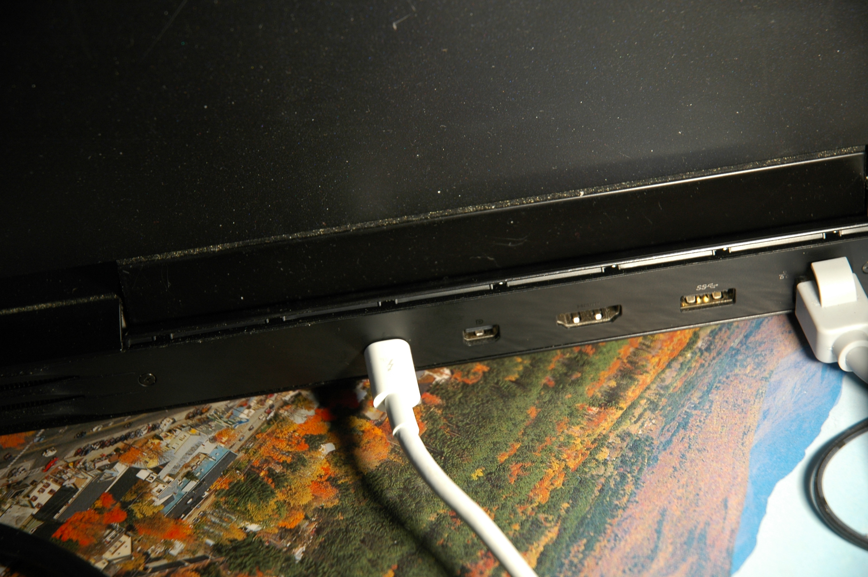

    Post a picture of your thunderbolt port on the computer, Are you sure it is not displayport with DP logo, If so it wouldn't work despite being physically identical to TB port.
    If you are using a USB-C TB port then you need to check the TB app software and make sure it pops up when you insert the cable into USB-C TB port.

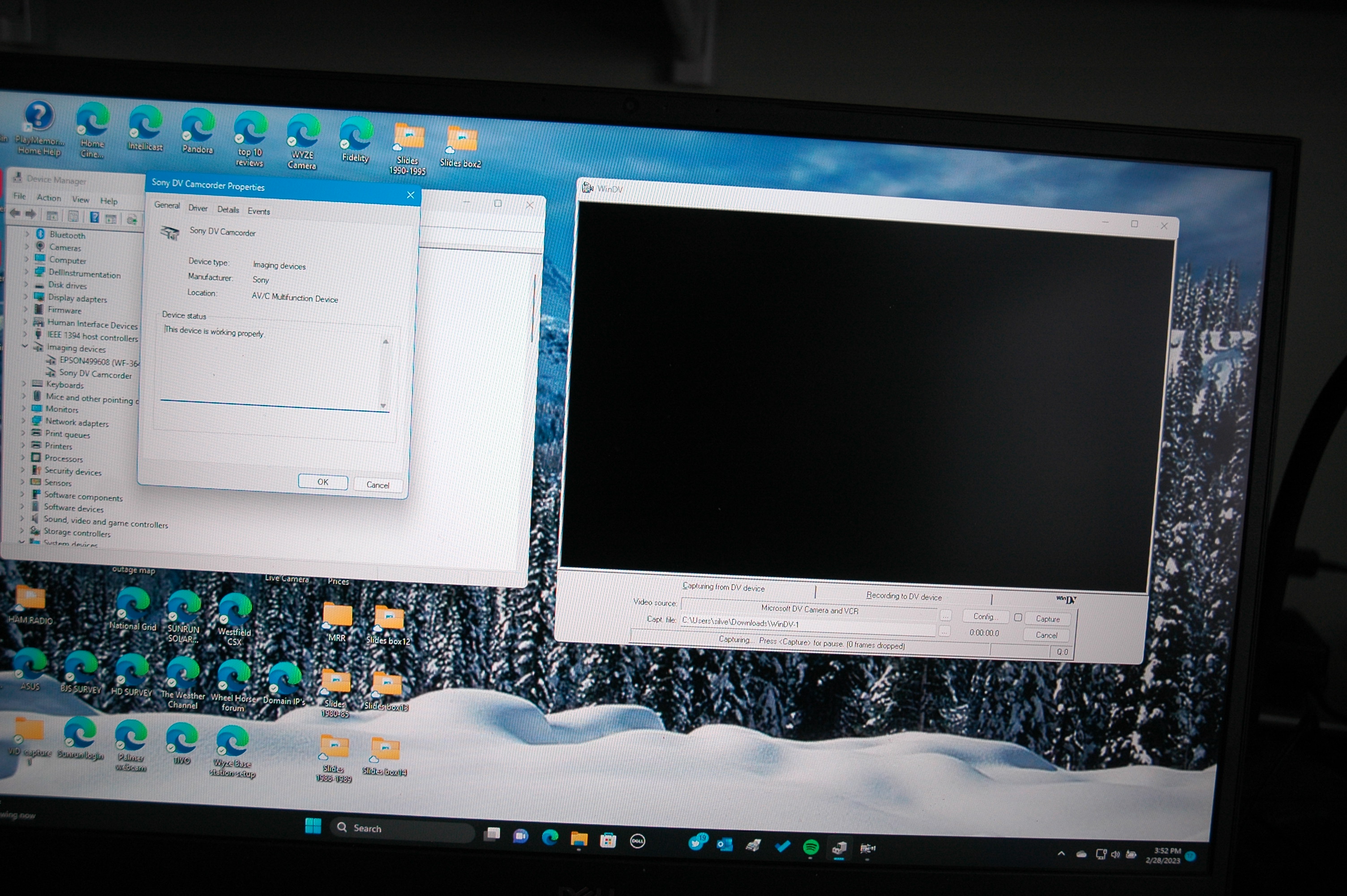

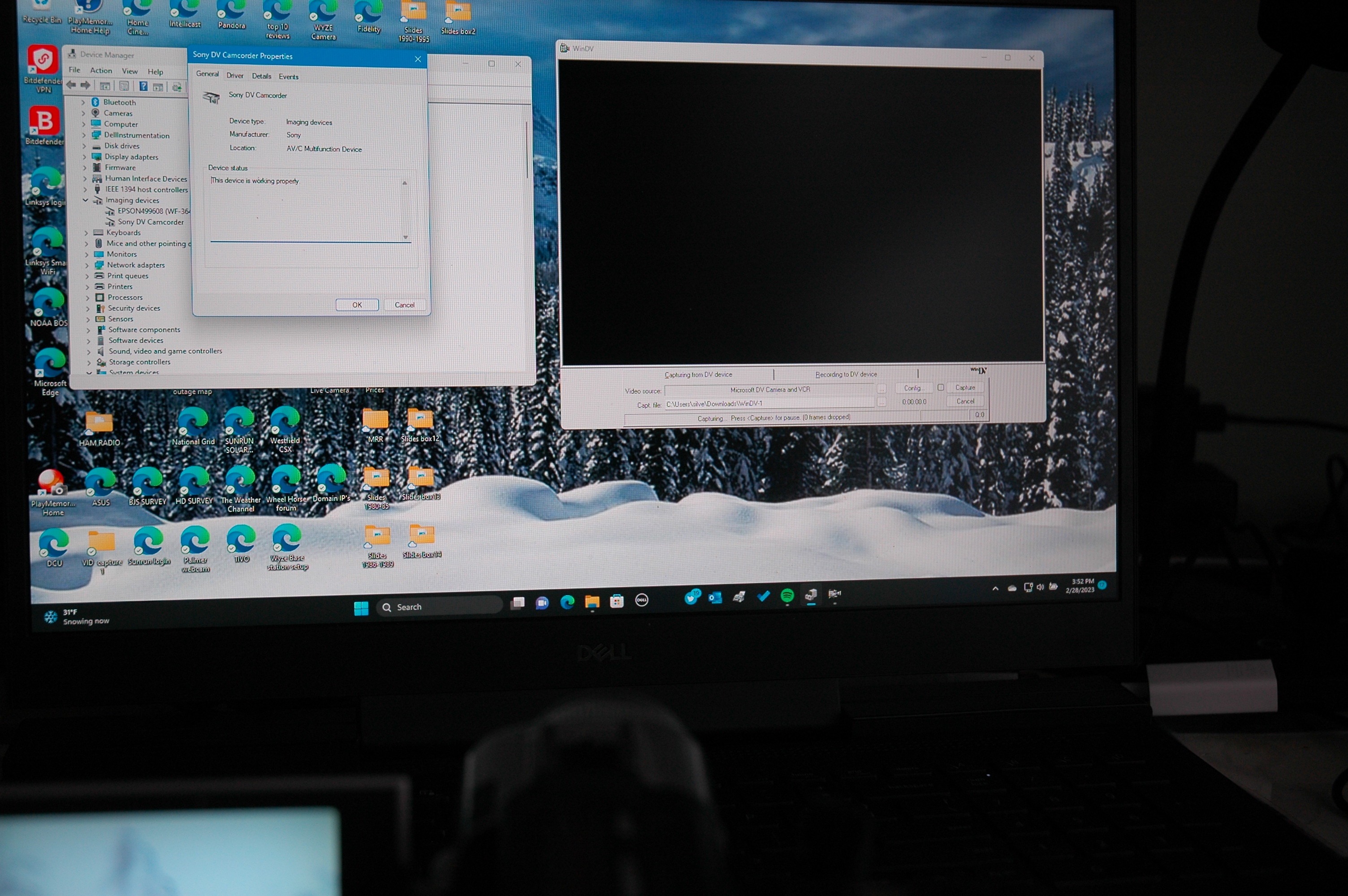

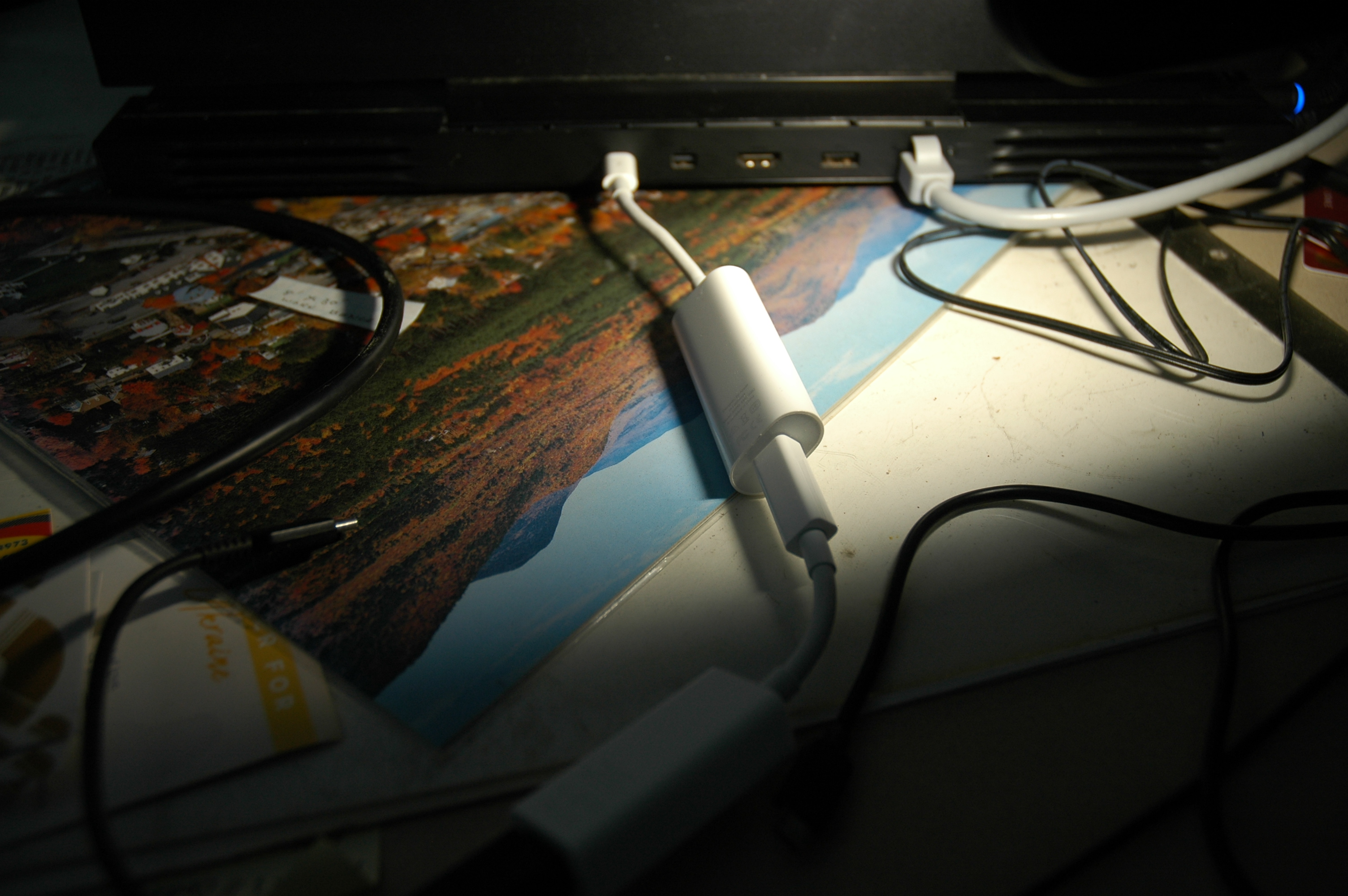

    dellsam34,here are some photos of the hookup to the Dell G7700 Laptop, as weel as screen shot of Device Manager, as well as the WinDV screen, showing "capturing" but nothing on the WinDV screen.Image
    [Attachment 69500 - Click to enlarge]
    [Attachment 69501 - Click to enlarge]
    [Attachment 69502 - Click to enlarge]
    [Attachment 69503 - Click to enlarge]
    [Attachment 69505 - Click to enlarge]

    winDV should say sony dv camcorder in the video source box. click the square button with ... to the right of current source to see if the sony is listed, if it is switch to it.
    Feb 2023
    It says Microsoft DV Camera and VCR now, and when I check the box next to the right all it has listed is "Integrated Webcam"

    @Winterhawk, I just noticed your earlier observation about "LSI" IEEE1394 host controller. Mine is "OHCI":
    [Attachment 69533 - Click to enlarge]
    I assume that came from my install of the Startech IEEE1394 driver procedure.

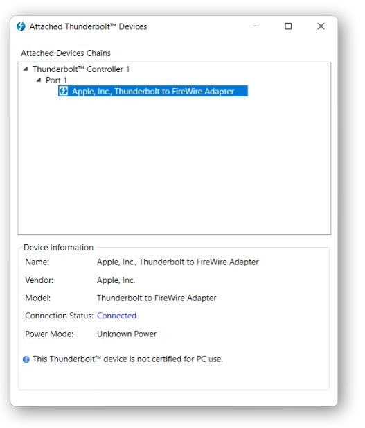

  21. Capturing Memories dellsam34's Avatar
    Jan 2016
    OP, Did you try to discard the TB to USB adapter and connect the firewire to TB adapter directly to the TB port, Or is it a display port? I can't make out what it is from your pictures. But again search and run the TB app in your system, If you can't find it you may need to update your laptop drivers from the manufacturer.
    I tried a laptop I have a day ago (Lenovo Legion - Win 10) with a DV/HDV deck and was exactly in your situation, it just diplays balck screen, Went into the BIOS and couldn't find an option to enable the TB feature, So connected the laptop to Lenovo web page and did an automatic search for missing drivers and it found one driver missing, guess what it is, The TB driver. After a successufull installation of the driver and a reboot I was able to see the Apple adapter in the list of devices in the TB app (I have the exact Apple adapters you have). Switching from DV to HDV though or vise versa requires unplugging and plugging back in the adapters, but otherwise works flawlessly. I do have a Sony laptop with the original iLink port using Win 7 for this kind of firewire work, DV, DVCAM, HDV, D-VHS ...etc, I just wanted to see if I could run it on a modern laptop, and it did.
    If you don't see the adapter listed like in the attached screenshot that means something wrong.

    Dellsam, thank you for taking time to do that research. I am going to recheck my drivers for TB, the last time I checked two days ago everything was as it should be. But, I am going to open the TB APP to see if it indeed has the Apple TB firewire adapter listed, good point. Device manger sees the Sony camera OK every time I turn the camera ON, so that signal is getting through the adapters and cable OK. Video is another story. I did not try going directly from the 4 pin mini IEEE port on the Sony to the Laptop TB C port, I don't have a firewire cable that goes directly to TB C. Another point of interest; Scott Schramm does an EXCELLENT Utube video of using WinDV on a windows 11 Laptop, however it does NOT work (yet) with Intel processor above 10th generation, why, I do not know, and Scott is looking into this I believe. My DELL Laptop is a 2022 , i7 processor, running windows 11, 10th generation processor.

    What I meant is the other port next to the USB-C, The one that looks like a display port, If that's a TB you can skip USB-C and use one adapter only from firewire to TB.
  24. Member
    Feb 2023
    dellsam 34: The port next to the Thunderbolt 3 USB Type-C port is a Mini Display Port
    The spec on Dell sheet says it connects to a TV or another Display Port-in enabled device. Provides video and Audio output. It is NOT TB unfortunately.
