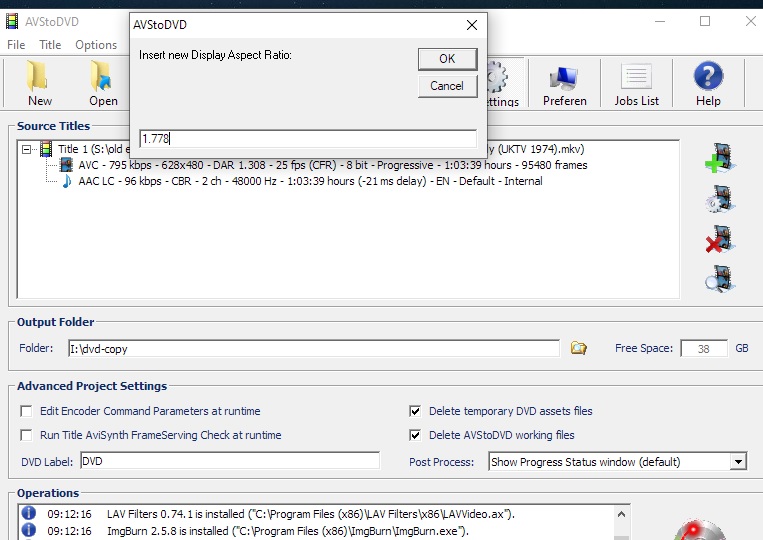

    You shouldn't be wasting disks, test the iso/video_ts folder in VLC before burning.
    There is a way to tell A2D the correct A/R as well as other attributes by right clicking on the file in the main window
    Edit source title info/video display aspect ratio/ 1.78
    You should also check the interlaced/progressive status to make sure that is also recognized properly

    Mar 2008
    Works for me.
    The way you did it will complete but in some situations, the correct cropping will not be applied to the picture.
    This is because a2d crops/adds borders based on the default or this value

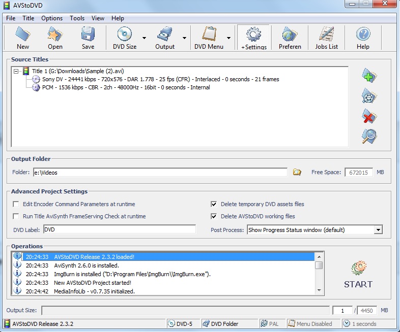

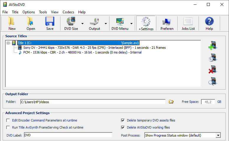

  18. I dropped this sample into AVS and it shows DAR 4:3. I dropped previous sample with a healthy segment and showed 16:9.
    Maybe it's a glitch indeed, at least it can be fixed with command line parameter edit on my part. I will be inspecting the endings of files more closely for such anomalies and if I see 4:3 in AVS that would be a red flag, though I don't use ti that often, as less and less people want tapes to DVD, which is a good thing.

    There is clearly a conflict in information. Here is what my vers. of a2d produces for the second sample
  20. I have version 2.8.8.
    I will try to locate and instal 2.3.2.

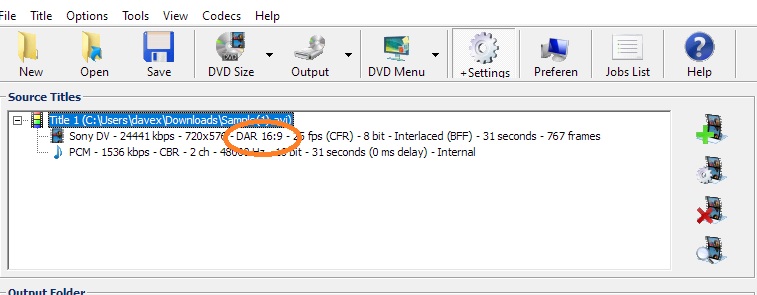

    Mar 2008
    2.89 identies it, no need to go down to such an old version

    You took the healthy 31 second file, not the second sample that si actually corrupt.
    2.8.9 showed me 4:3.
    So now I will be on a quest to find out at which version does it change.
    upgrade to 2.89 and right click the file in the project window and set 1.78 as we discussed earlier
