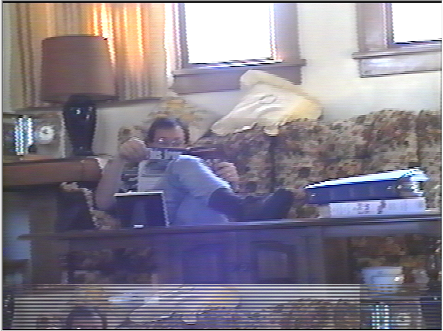

    I'm getting partial frame overlays randomly at the bottom of the screen while video capturing and not sure what to even call it so I can start researching. Is there a name for it that will help me find the root cause / fix? Attaching an image for an example.
    Thanks so much in advance, appreciate any help.
    [Attachment 69422 - Click to enlarge]

    Without a sample video and what capture hardware and software and format you are working with, no one will be able to help.
  3. Hi!
    Capture hardware is Roxio Video Capture USB (directshow)
    Software is VirtualDub 1.104
    Format is VHS. Capturing to avi through a VCR.
    https://youtu.be/ppujsjZixHk
    .... Ok, this is strange, it isn't happening on the video after uploading to youtube. Here's a link to the source file
    And apologies for the bad grammar on the title, still 1/2 asleep.
    Thanks again

    It could be VDub display problem. Not sure why your sample is RGB and 640x480, It should be YUV 720x480.
  5. Captures & Restoration lollo's Avatar
    Jul 2018
    Italy

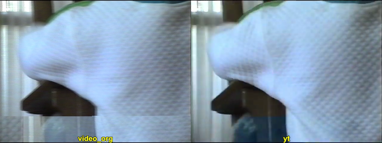

    The odd field is corrupt. It can be a glitch in the tape (even because there are 2 "inserted" frames before the corrupt one) or the VCR .
    If occurring rarely, it's easily fixable in post-processing with a frame interpolation.

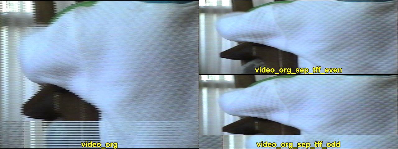

    The defect is also present in the yt video, but it is mitigated by the mp4 compression (and by deinterlacing?) and spread to both fields:
    Definetely your capture should be lossless 720x480 YUV.

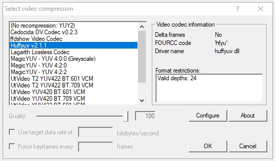

  7. No luck. Hopefully I followed the instructions correctly. I installed the huffyuv and captured at 720*480 (I think)
    https://files.videohelp.com/u/305044/retest.avi
  8. Also, for reference, I've tried 2 different VCRs. Checking other tapes to see if it happens there too.
  9. Member DB83's Avatar
    Jul 2007
    You might have installed the codec but you have not selected it from the compression settings. You video has not changed codec (or lack thereof) from before.
  10. If nothing helps, try something like
    AVISource("retest.avi")
    ConvertToYV12(interlaced=true)
    AssumeTFF()
    QTGMC().SelectEven() #keep the good fields only
    You will loose 50% of the temporal resolution though, and introduce jerkiness where the fields are corrupt or missing.
    The capture has all kind of defects though (glitches, dropped fields or frames, parity flips ....)
    So yes, first is to revisit your capture setup, and capture to YUV (YUY2) rather than RGB. Otherwise garbage in - garbage out.

    Video>Compression:

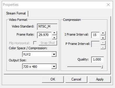

    Video>Capture PIN (assuming you're on NTSC_M):
    [Attachment 69448 - Click to enlarge]

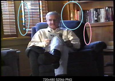

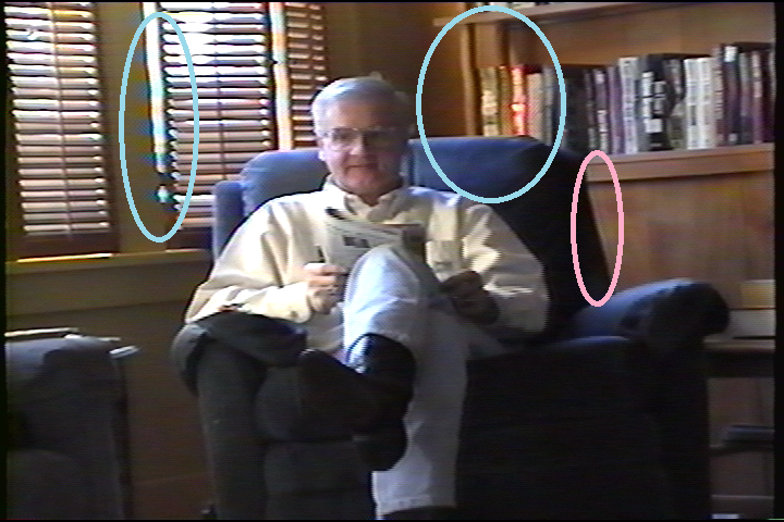

    In addition to what Sharc properly said, your capture suffers of halos; try to reduce/remove the sharpening in the VCR or in the Capture Card.
    You also need a lineTBC correction to have verticale lines straight and not like they are. Upgrade to a better VCR with lineTBC or add a specific DVD-R Recorder in pass-through mode.

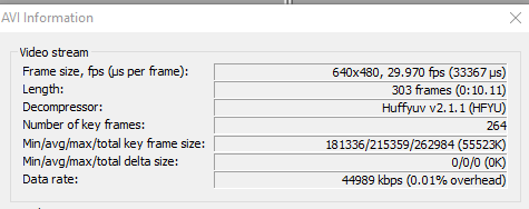

  13. I think I have it capturing Huffyuv 2.1.1 but stuck on the resolution of 640 X 480. Not sure where to set for 720 X 480.
    I'm also using VDub 1.10, is 1.9 the preferred version?
    Thank you all for the info, a lot to absorb after being away from video capturing a long time (and not really knowing it that well when I first worked on it years ago).
    The resolution is set on the Video>Capture Pin screen. There's a dropdown menu for it called "Output size".
    What is available varies, depending on the capture card, but you should have a 720x480 option for NTSC.
    Also, try Video>Custom Format (down the bottom). You can set the frame size there.

  17. You need to get your capture process fixed. The problems in your video (duplicate frames, dropped frames, and torn frames) have two main causes: time base errors in the source signal, and CPU and disk speed errors on the computer.
    Time base errors can often be fixed using a DVD with line TBC on its passthrough (US$100+). If that's not enough you may need a full frame TBC (US$1000+).
    Computer speed errors are generally fixed by using a fast lossless codec during capture (this reduces the disk data rate requirement, a common problem) and saving the audio as uncompressed PCM (don't waste CPU time compressing the audio). During capture a new frame arrives from the capture device every 1/30 second. If the computer busy when that new frame arrives it may be missed, causing a "dropped" frame, or the previous frame may be written again causing a duplicate frame. So avoid any other video or audio processing during capture. Do those thing later when timing isn't critical. Whenever possible capture to a drive that's not your boot drive. Windows is creating, deleting, and modifying log (and other) files on the boot drive all the time -- that will interfere with your capture.

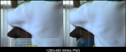

    In a worst case scenario (ie when it's impossible to get a clean cap) your sample video could be fixed in AviSynth. But it can be a lot of work and results won't be perfect. See attachment, original video on left, fixed on right.

  20. I'm thinking it's a hardware / source issue. I see it happening when I simply preview the video, no capturing happening. Trying some different capturing hardware later today / this week. But I'm thinking it's more likely the tape itself. They are all over 20 years old and were not stored optimally (best practice is not to store in a paper bag). As Sharc wrote 'garbage in / garbage out'.
    Appreciate all the comments and will keep working through it and try things mentioned in the thread, reporting back with any updates.

  23. Quick update I borrowed another capture device and the video looks much better. 720x480 shows up and no glitching so far. Appreciate all the responses, such a great community.
