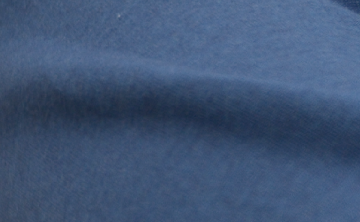

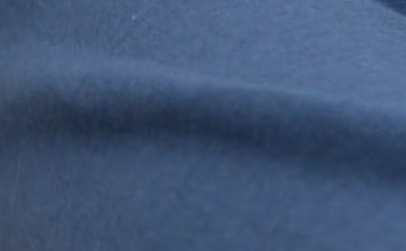

  14. comparisons of just first frame I could come up with randomly, to see texture of clothes:
    frame 140, crop clip = clip.std.CropAbs(width=768, height=432, left=1012, top=1074); numpy_crop[1074:1506, 1012:1780]
    so this is selected crop:
    [Attachment 69429 - Click to enlarge]
    this is original (not 1:1, but anyway, good enough for comparison)
    [Attachment 69430 - Click to enlarge]
    and this is encoded part:
    [Attachment 69431 - Click to enlarge]

  16. Yes, one has to zoom in, to actually see what is going on with texture ...
    But op says cropping is a "faulty way to determine quality". So that is why I posted it. To not look what I got?
