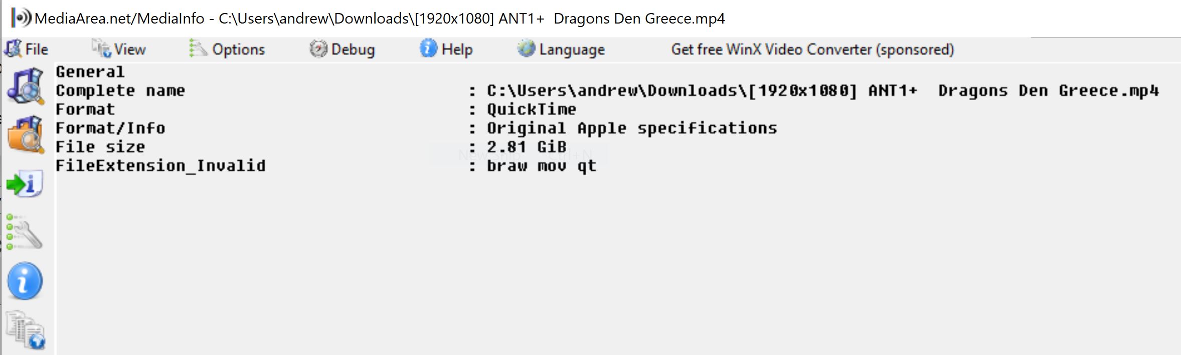

  9. medianfo shows:
    General
    Complete name : C:\Users\andrew\Downloads\[1920x1080] ANT1+ Dragons Den Greece.mp4
    Format : QuickTime
    Format/Info : Original Apple specifications
    File size : 2.81 GiB
    FileExtension_Invalid : braw mov qt
    I just downloaded MKVToolnix will give that a go and report back
  10. just tried to open the file in MKVToolnix and got a popup "unrecognised file format". the file.......was not recognised as a supported format (exit code: 0)

    Thats why I siggested putting mediainfo into view/text mode, it give much more info. Do that and post it all here
  12. Image
    [Attachment 69338 - Click to enlarge]
    The information is above..

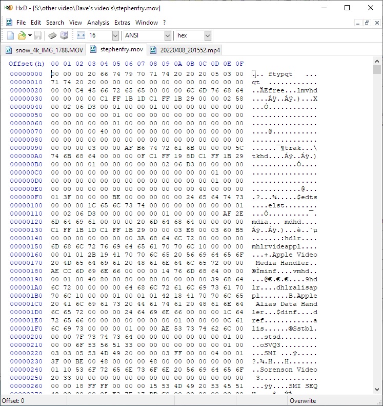

    If you open the file with a hex editor (here I'm using HxD) you can see the typical mov/mp4 header at the start of the file

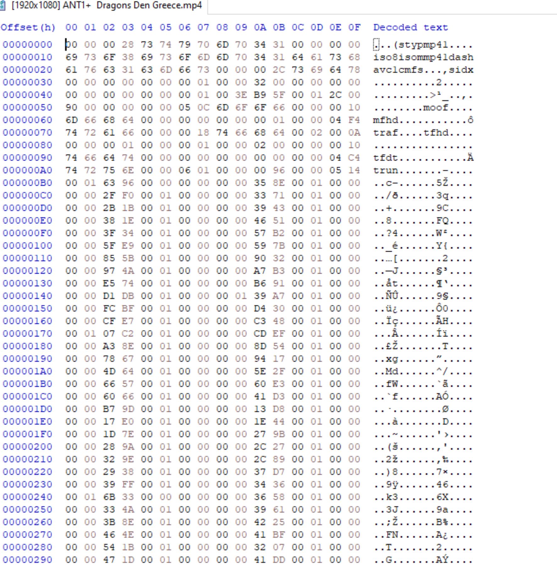

  14. Image
    [Attachment 69340 - Click to enlarge]
    this is what mine looks like in HxD.
    I dont think its protected as I selected the protected column in the properties of the file and its blank - so no DRM.
    If it is corrupted, then i guess its the Video Downloader Plus plugin i am using in Chrome to download it - is doing something very weird with it. Although I dont see any issues, becuase at the end of downloading it prompts me to save the downloaded file, which appears to do so successfully.
