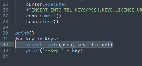

  2. you havent actually said what the issue is other than "i cant get it to work".....
    next time try to add some more detail, like what youre expecting to happen and any errors you get when running the script.
    im assuming that when you run the script, you get the keys printed out but then nothing appears in the db.
    is that correct?
    if so, you havent called the insert_table function in your python script.
    you need to add this under the "for key in keys:" line
        insert_table(pssh, key, lic_url)
    is that correct?
    [Attachment 69204 - Click to enlarge]
    is that correct?
    yes that's my problem. When I insert this insert_table(pssh, key, lic_url) gives me this error NameError: name 'insert_table' is not defined...
  4. can you upload a screenshot of your full script?
    the one you pasted above has no indentation
    Update: script is fixed, it had an extra parameter in the insert_table function.

  5. BTW, instead of splicing strings into SQL queries like this
     f"INSERT INTO TBL_KEYS(PSSH,KEYS,LICENSE_URL) VALUES ('{pssh}','{keys}','{lic_url}')")
    you should use placeholders to bind the values, something like
    cur.execute("insert into test(d, ts) values (?, ?)", (today, now))
    More secure/robust.
