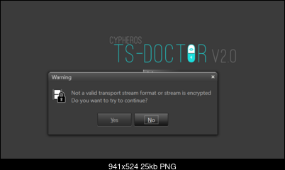

  12. https://forum.videohelp.com/attachment.php?attachmentid=69209&stc=1&d=1676369679
    File attached, hope this is of any help
    Maybe the files need finalising on the TV, but looking at the manual it doesn't mention this needs to be done, unless I've missed something.
  13. Captures & Restoration lollo's Avatar
    Jul 2018
    Italy
    If not corrupt for any reason, the file is encrypted and can be played only on the TV where has been recorded. I ignore if a hack exist for your specific TV:
