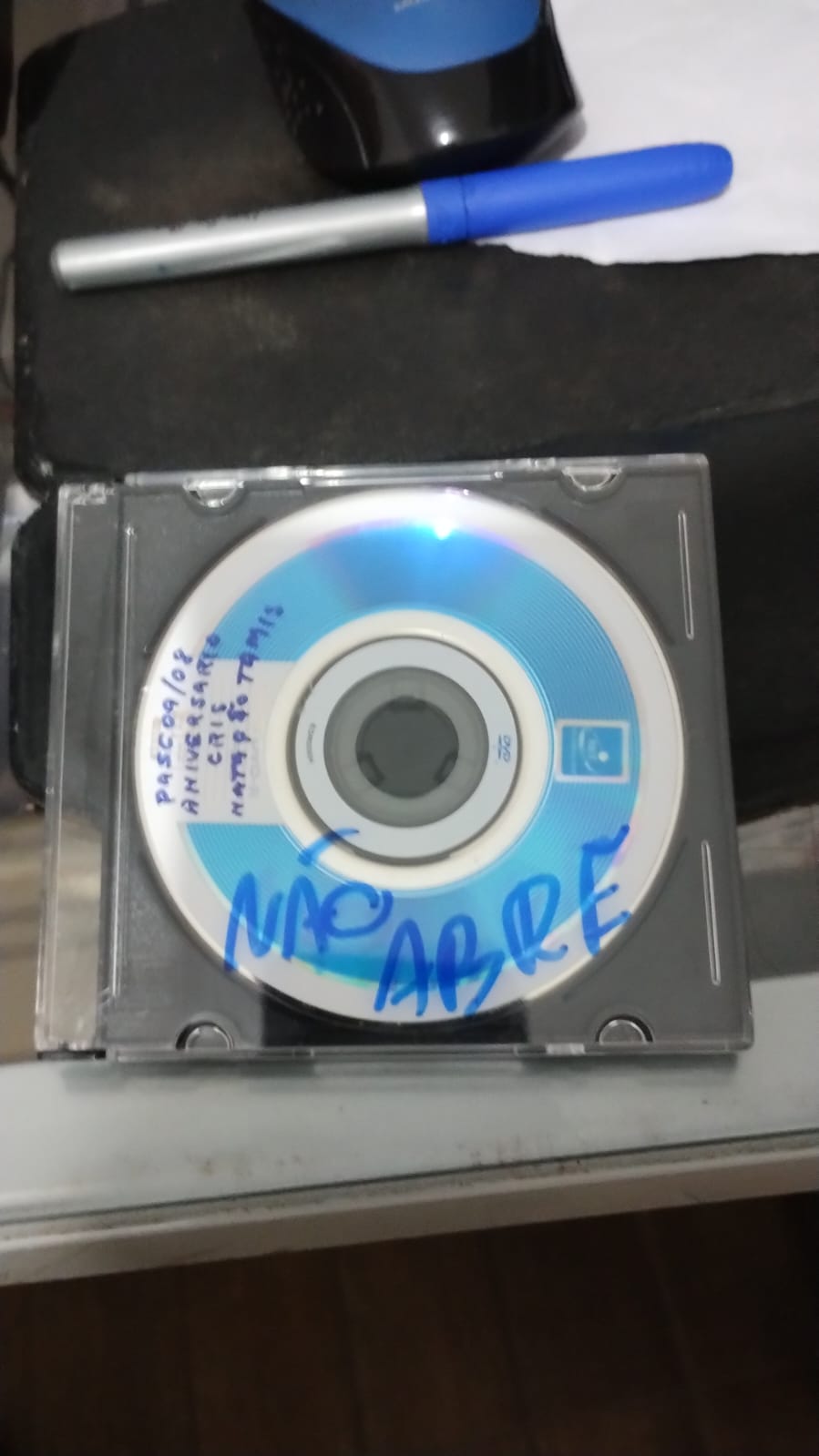

    Does anyone know a program I can use to finalize these mini DVDs or open the content to extract?
    There is no longer the original camcorder. The files do not appear because the disc was not finalized in the camcorder itself, but it is the video recording signal.

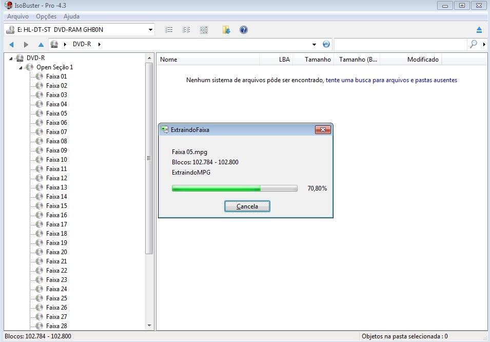

    [Attachment 69178 - Click to enlarge]
    I tried with isobuster and it worked, however, I followed the tutorial in a youtube video, it only worked when the internet was off, installing the program etc, I should have copied everything, but I left it for another day, it seems when I turned on the internet, the program asked to activate and payment key and no longer let me do what I want.

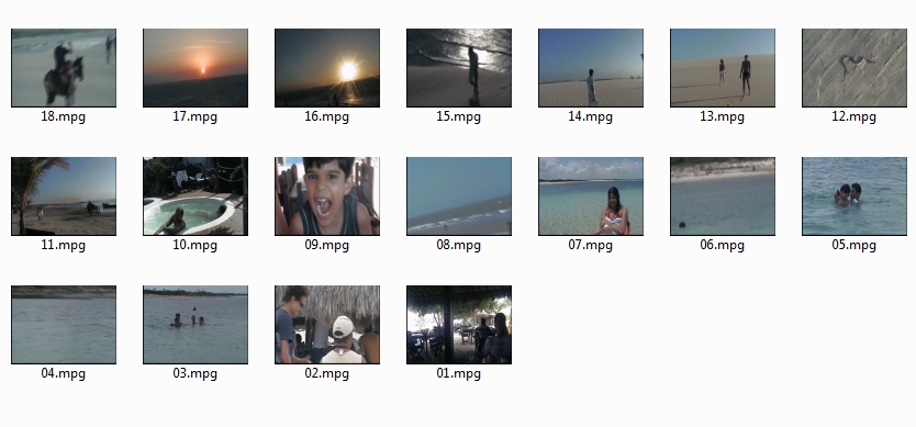

    So, I did it, I was able to recover using the isobuster itself, it didn't work with the other ones posted here.
    Well, I can't save with the original video file, mpg, but isobuster gave me free option to save the ISO file.
    What did I do? I just renamed the ISO file to MPG. And voilá, it looks like this.
    [Attachment 69180 - Click to enlarge]

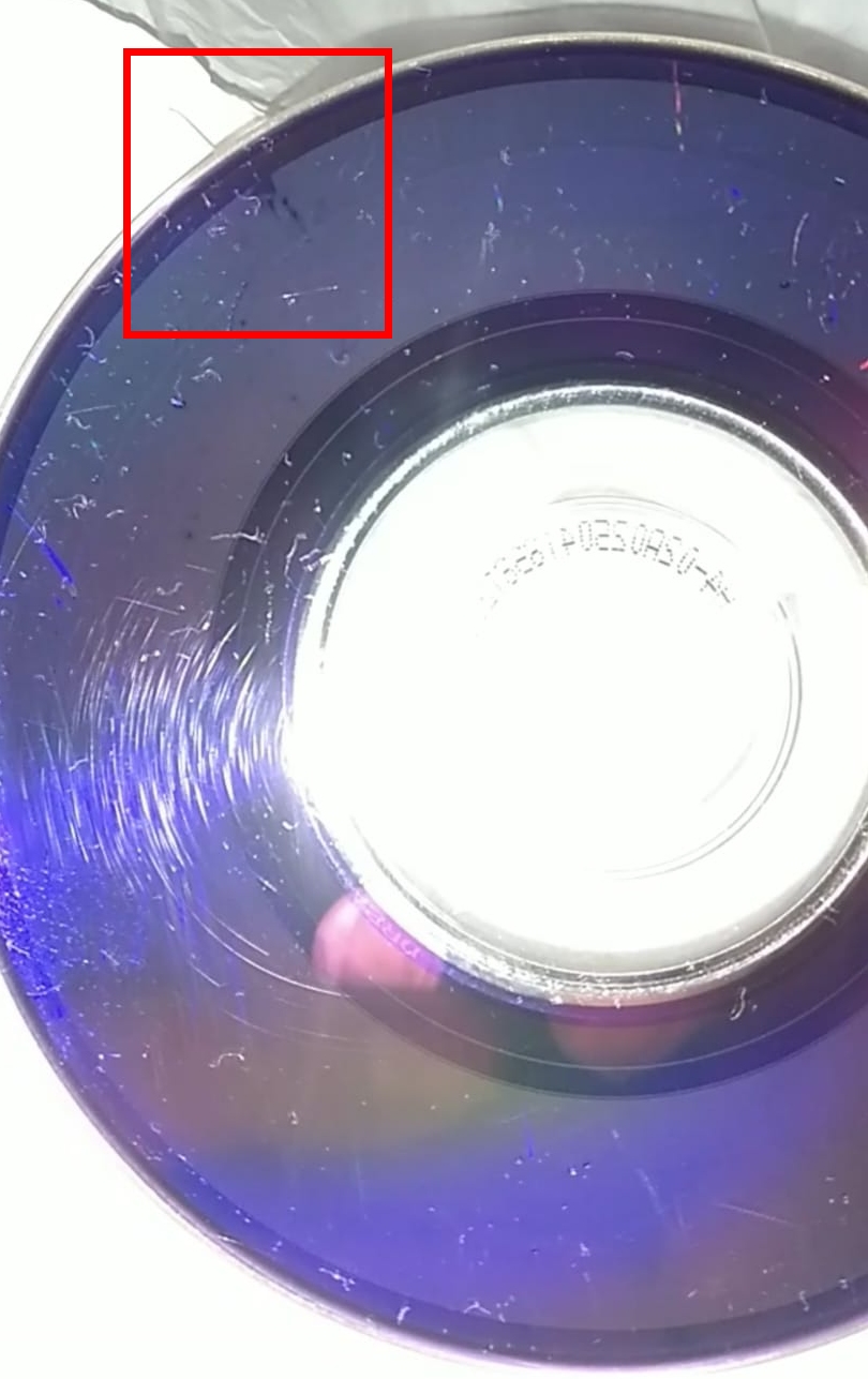

    Too bad that some of these mini dvds were quite corroded by fungi, at least 3 parts of videos were incomplete, because the DVD player laser could not read and maybe because this?
    [Attachment 69181 - Click to enlarge]
