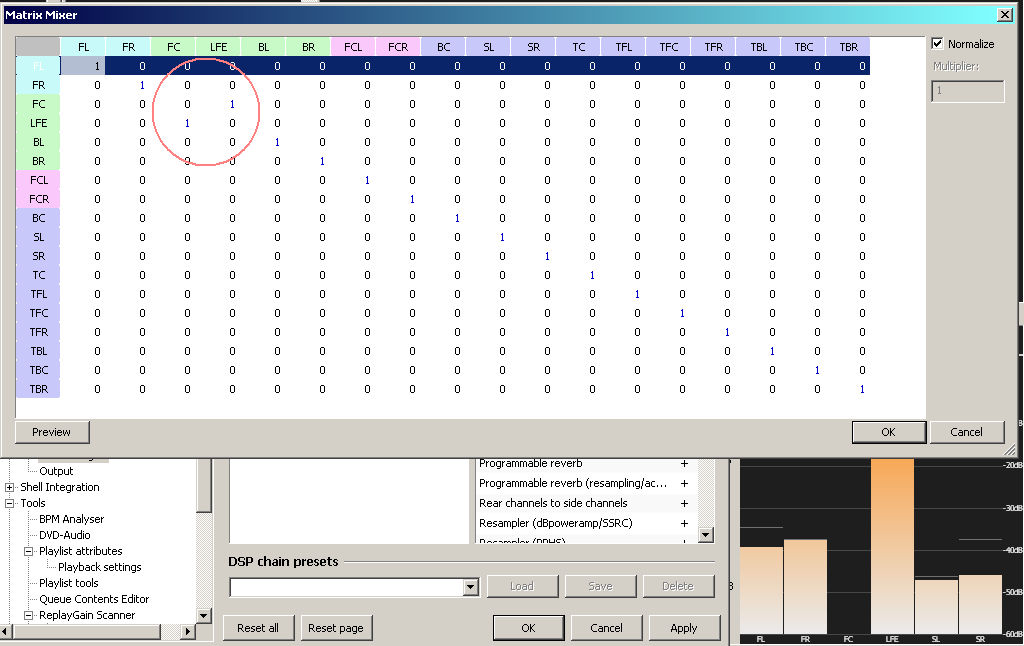

If you want to play around with channel mapping, try this version of foobar2000.
https://forum.videohelp.com/threads/396860-foobar2000-portable-(for-audio-encoding)
The output meters will show you which channels are being used (if you right click on the output meter you can run it full screen) and there's a Matrix Mixer DSP included you can add to the playback chain (or the conversion chain) and change the channel layout with it.
Swapping the Center and LFE channels, just to demonstrate.
[Attachment 69275 - Click to enlarge]
PS When it's using them, the BL & BR channels on foobar2000's output meter are labelled RL & RR (rear) for some reason, but they're the same channels.Last edited by hello_hello; 17th Feb 2023 at 15:41.
