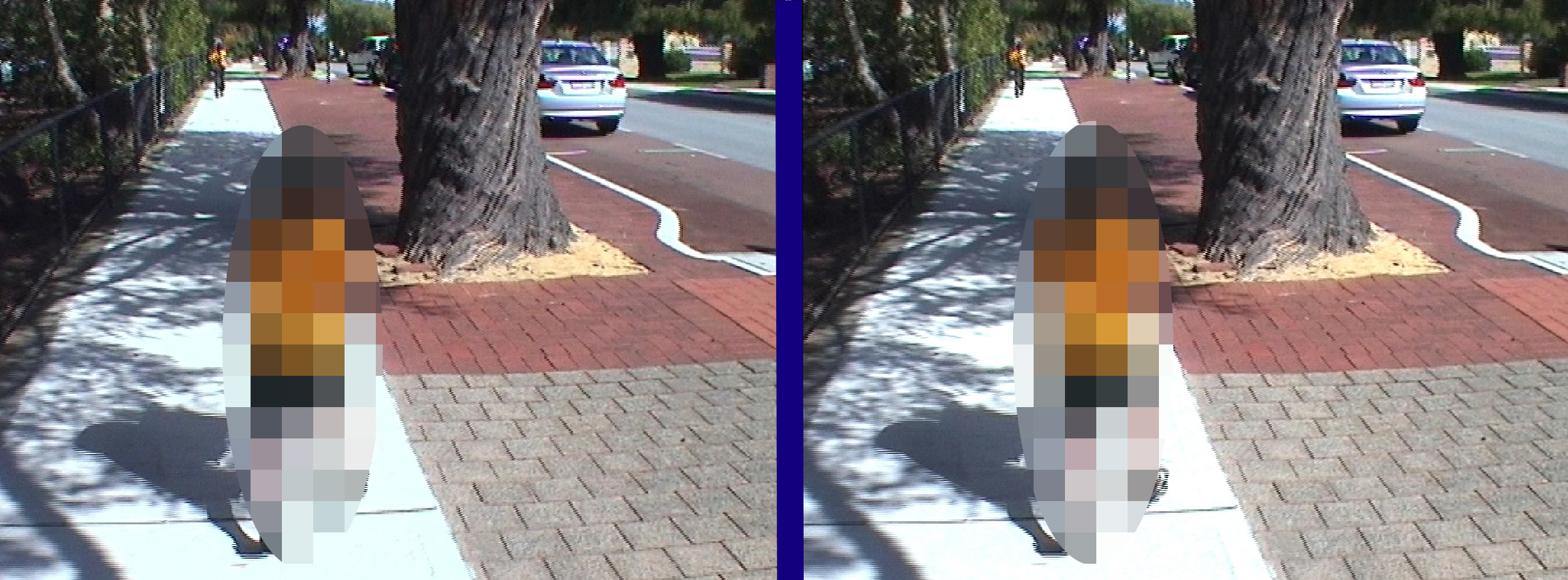

    Especially if using S-Video, analogue capture from a DV camcorder isn't as shocking as you lot are making out. Here's a comparison capture.
    For the analogue, I used S-video from my PAL D8 camcorder to a GV-USB2 capture dongle.
    [Attachment 69174 - Click to enlarge]
