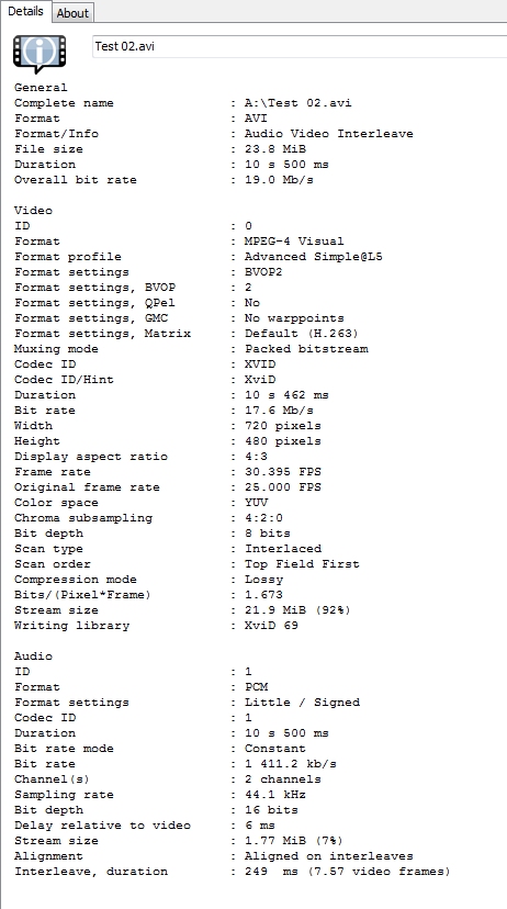

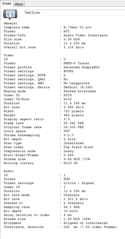

    I left two files with the specifications of each file, one in the maximum quality of the Xvid codec and another of the same snippet from the VHS NTSC tape at a quality close to maximum of the Xvid codec that does not generate a huge AVI file (and that one I usually do more that way, because I see that the final quality is the same.)
    I make my own configuration to convert, I tried to get close to the quality that the DVD record makes at maximum quality and I always get good results.
    But I always want to improve, with the tools I have for now.
    That's why I ask you guys to evaluate me, tell me what I need to improve. Am I doing it all wrong? Something I have to change?
    Anyway, analyze my conversion and tell me the negative and positive points I got. I'm open to very strict criticism!

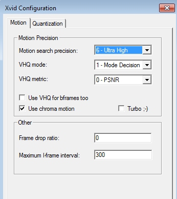

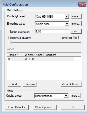

    [Attachment 69136 - Click to enlarge]
    [Attachment 69137 - Click to enlarge]

    Audio for video is always 48KHz, not 44.1KHz.
    Dec 2022
    Brasil
    Yes, I always do that, I left the 44.1KHz unnoticed when converting this section.
    I know you are an expert, anything else different or wrong, please tell me.
  4. Do you actually capture in xvid or it's just an aftward convertion ? Capturing would be a no-no from me.
    By the way, the frame rate seems to be non standard 30.362 fps
  5. Any particular reason to use XviD instead of h.264 for final output? Xvid and the like is kinda antiquated and there is not much reason for using it over better formats unless you want to play the files back on some device that supports that but not later formats.
    The framerate should also be set as 29.97, not 30.
    Yes, i do capture in xvid. So, what should I do?

  8. Member Cornucopia's Avatar
    I didn't look at the videos yet, but that doesn't matter because the specs say enough:
    1st one is MPEG4-Version2, Simple Profile (the kind often encoded by Apple Quicktime, pre-AVC)
    2nd one is XVID. Aka MPEG4-Version2 Advanced Simple Profile
    It's no surprise it is better because it is using more advanced algorithms.
    BUT...
    It was good as an option for up until ~2006-2007. Since then, AVC, aka h.264 aka MPEG4-Version10 (with many profiles) is tons better in quality. And it has been the best option for capable/supporting devices since then, until about 2018-2019, when HEVC aka h.265 aka MPEG-H (also with many profiles) became good enough and now IT is often the best consumer option, especially with > HD resolution stuff. There are other ones better still on the horizon, but they are so complex that they aren't good options for day-to-day devices yet.
    So the question comes back to - what devices are you playing this on, and do they also support something better such as AVC?
    If so, you should notice a big improvement over XVID, not to mention MPEG4 simple profile stuff.

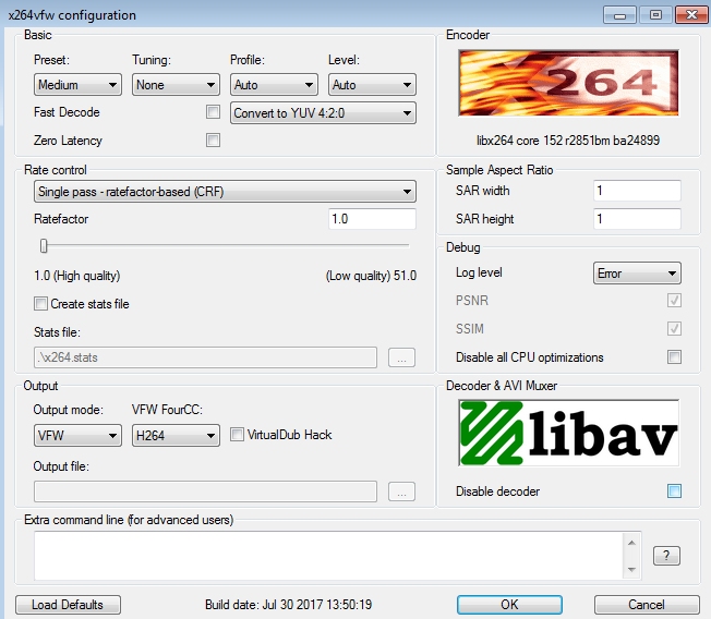

    I don't remember testing this codec you said, but I will. Is there something in here about how to install and download?
    another question, will my computer support this encoding?
    Note: My pinnacle capture card only supports up to 720x480
    By the way, i have this installed: Image

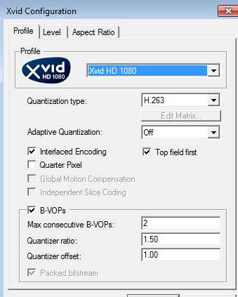

    [Attachment 69155 - Click to enlarge]
    @Cornucopia
    @Cornucopia
    So, i wanna try this... Is the one you mentioned? @Cornucopia ?
    Can you teach me the exact setting to select?
    As I said, I've tested several codecs, but I may have done something wrong using this one.
  11. Video Restorer lordsmurf's Avatar
    FYI, that x264vfw gives non-standard output.
    So many "smart" (dumb) TVs won't play it, many BD players, media center boxes, etc.
    If I want to be lazy, and snip up clips in VirtualDub, output this way, I still have to re-encode in Hybrid for smooth playback in all home devices. I've only had one personal TV show project where I wanted to be that lazy.

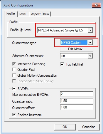

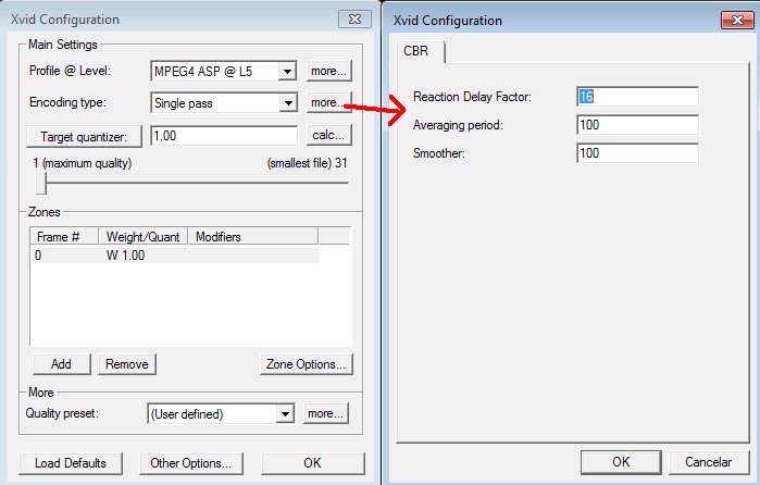

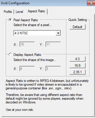

    Can i change to this? (marked in red) Image
    [Attachment 69217 - Click to enlarge]
    If someone can explain it to me, I would like to understand the other things, the ''interlaced encoding'' and ''top field first'' thing I already know.
  14. Member Skiller's Avatar
    Oct 2013
    Germany
    The profile and level choice is of any importance only if you plan on playing this on hardware (such as media players, DVD-players with MPEG4-ASP support). It limits certain settings to keep the video within the chosen profile and level to guarantee compatibility.
    "Quantization type" lets you change the quantization matrix to a custom one, but there really is no point in doing that, the standard setting is good.

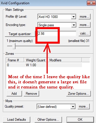

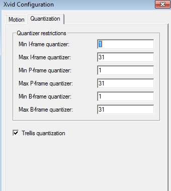

    How about that ---> Image
    [Attachment 69233 - Click to enlarge]
    Clicked on ''more'' of single pass, does it have something to do with lossless?
  16. Member Cornucopia's Avatar
    Don't start changing stuff if you don't clearly know what it does. Learn the ins & outs of how it works first.
    I would say, Get ffmpeg, and a GUI for it, and test with that, using "default" settings, to compare your encodes, varying the codec to see what is different.

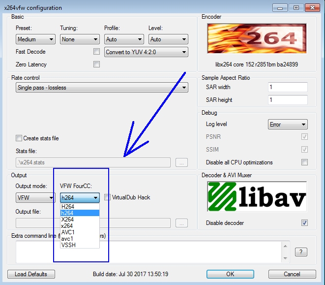

    Hello. I already did with ffmpeg, didnt like them, i would test with this one ---> Image
    [Attachment 69246 - Click to enlarge]
    But what would be the best configs? And why it don't have the interlaced encoding thing like xvid has?
    Sorry I'm about 40% layman.

    So, How can i use these codecs AVC, h.264, MPEG4-Version10 to test another way to convert ? Anyone? I use Windows 7 and 8.
  19. Member Skiller's Avatar
    Oct 2013
    Germany
    Don't bother with x264vfw. AVC in AVI is a deprecated hack and should not be used.
    Use something like HandBrake and use container formats such as MKV or MP4.

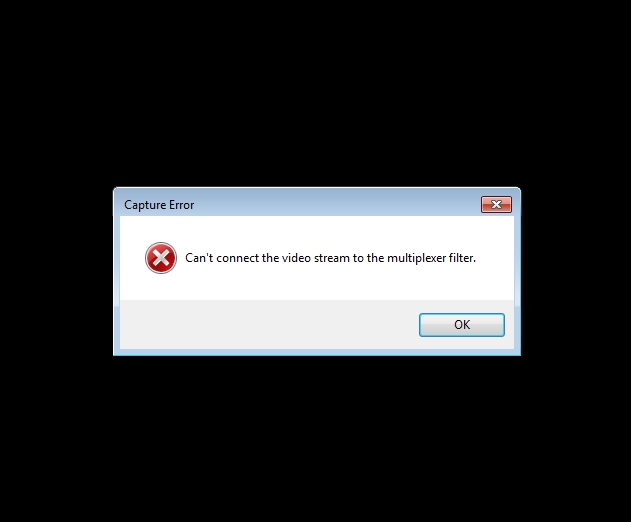

    Where? In the Xvid Codec? I didn't try the Image
    [Attachment 69614 - Click to enlarge]
    because it is giving an error while initiates
  27. Originally Posted by Litaiff View Post
    Is there any link for a video tutorial to use the Hybrid ?
    Hybrid is for postprocessing and encoding, not for capturing.
    For capturing you should
    - install a lossless codec like Huffyuv, Lagarith, or UTvideo for example
    - use VirtualDub or AmarecTV as your capturing software rather than anything else
    I am afraid you won't get much help with capturing to a lossy (=compressed) format like XviD or similar. But if you are happy with the results which you get it's just fine. Just wondering about the strange framerate. Dropped or duplicated frames?
    Capturing directly to compressed x264 is even more CPU hungry than XviD, so the risk of glitches increases.
    The fact is I'm not going to convert anything, just capture and that's it. I've always captured in AVI, I use Xvid Codec more because it gives me the option to select deinterlaced mode, the others don't.
    You're doing it wrong.
    Correct =
    1. capture lossless
    2. convert capture to delivery (H.264)
    Never capture to delivery. It does not work well, or at all.
    Stop using x264vfw.
