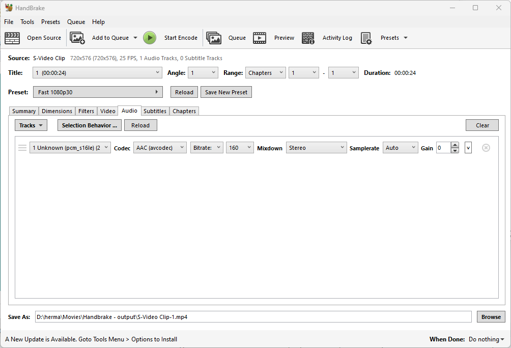

  5. Maybe handbrake converted the audio? I don't know.
    In Vdub2 you can either
    - select Matroska(*.mkv) as a container which will accept the PCM audio format
    - or re-encode the audio to AAC for example if you need it in .mp4.
    Edit: I just found that handbrake selects the AAC encoder automatically as its fallback default. See the audio tab/Selection behavior in handbrake.
    [Attachment 69052 - Click to enlarge]

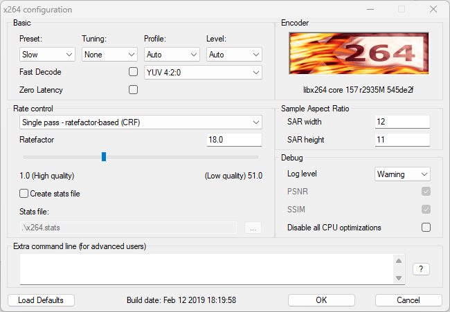

    Try the Slow preset, with Rate Control set to Single Pass - Ratefactor Based, with crf set to 18.

    You can configure the encoder for a higher quality. Set the Ratefactor to 18.0.
    Press the Configure button when you selected the codec to see...
    [Attachment 69055 - Click to enlarge]
