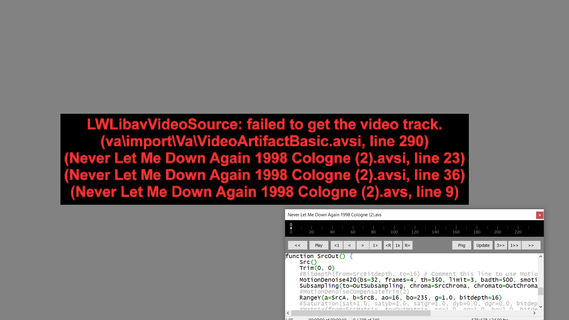

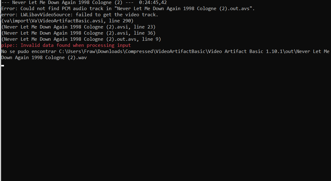

I'm new to this I'm starting in Video Artifact (the program for pc not avisynth) and I'm getting this error
to export the file out.bat
[Attachment 69044 - Click to enlarge]
And this is opening the file edit.bat
[Attachment 69045 - Click to enlarge]
Could someone help me? It seems to me that the problem is related to the audio but I'm not sure.

I don't use videoartifact, but "LWLibavVideoSource: failed to get the video track" - It means the LSmash build that the program is bundled with cannot open the video track , so you won't see anything
You can try updating the source filter because program looks abandoned since 2019. LSmash should be able to open mpeg2 in mkv, at least for avisynth directly
You can try looking for LSMASHSource.dll in the program directory and try to replace it (unzip from the archive)
https://github.com/HomeOfAviSynthPlusEvolution/L-SMASH-Works/releasesLast edited by poisondeathray; 3rd Feb 2023 at 22:19.

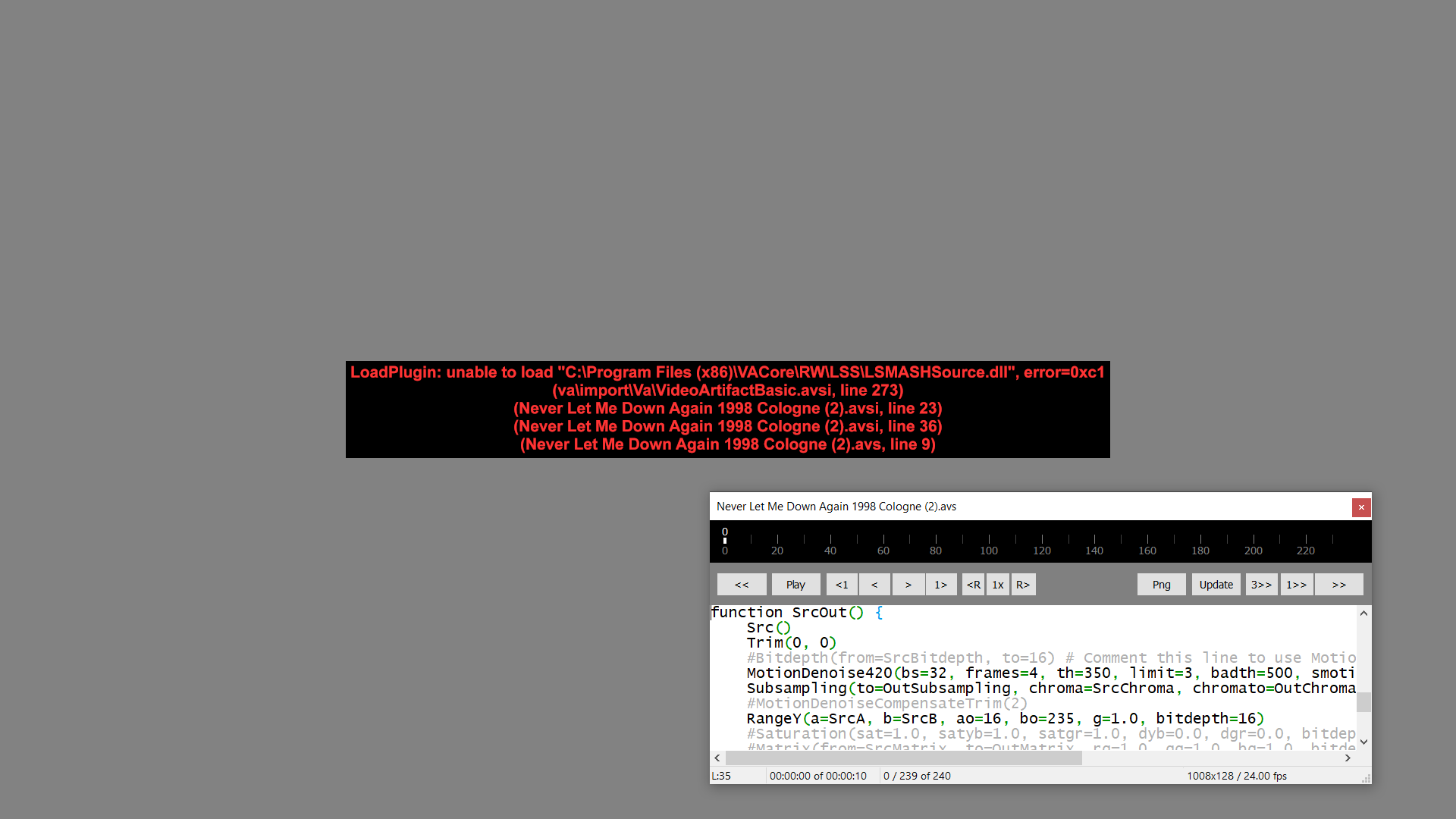

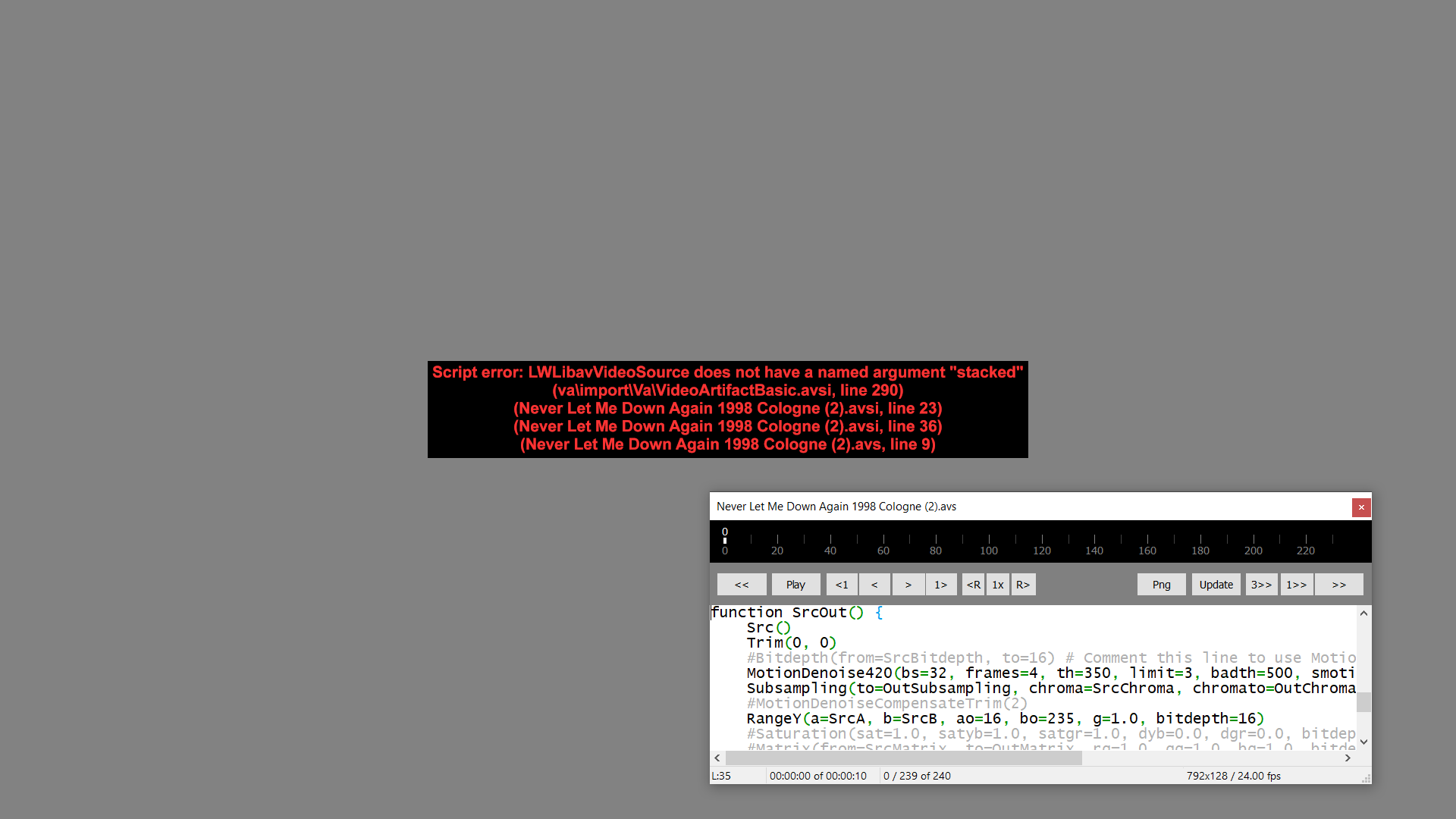

I tried what you said by downloading the latest build from github and this appears for the x64 version:
[Attachment 69058 - Click to enlarge]
and for the x86 version this:
[Attachment 69059 - Click to enlarge]
What can I do?
