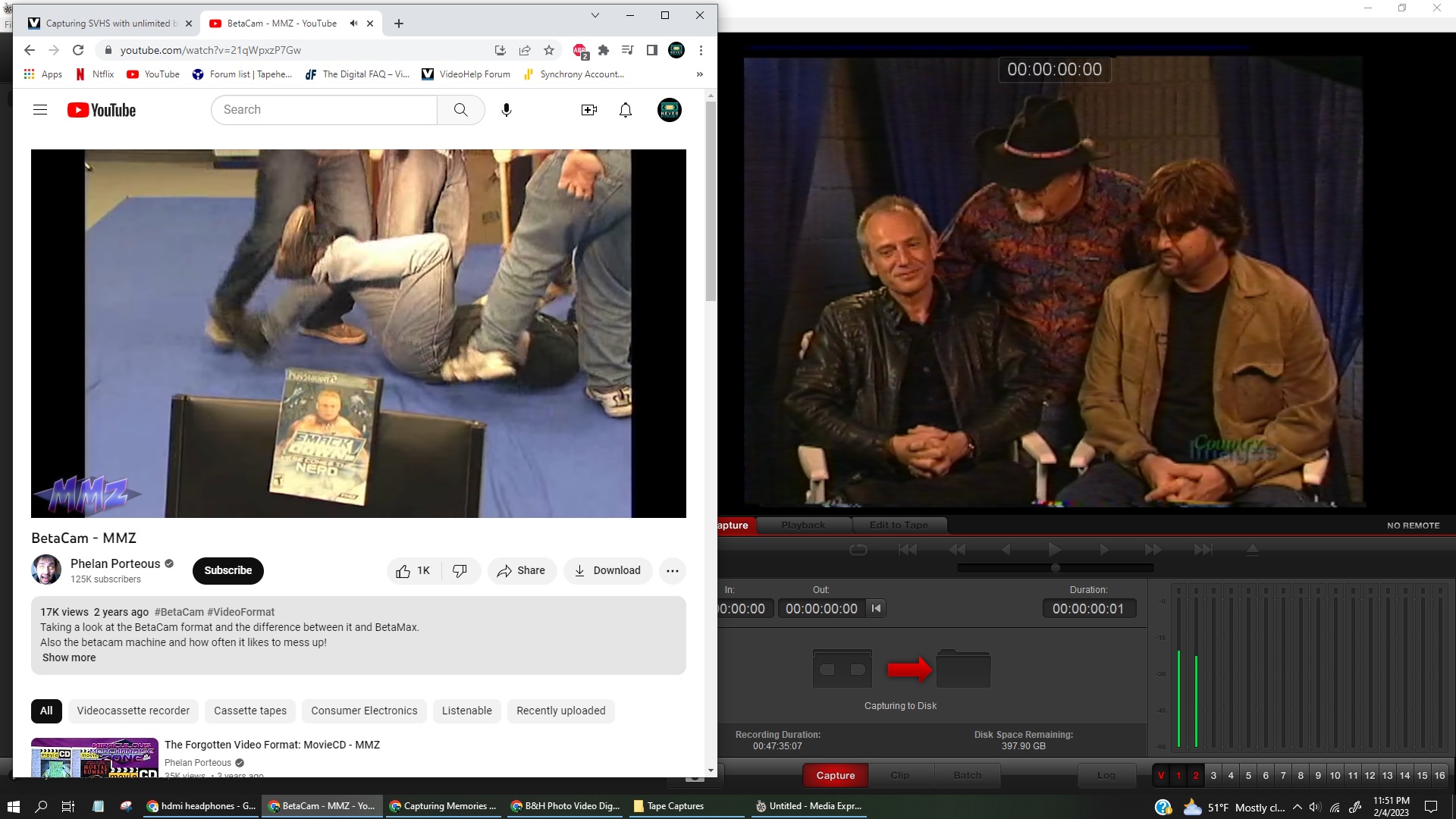

    SCART, S-Video, Dual BNC, they are different connectors but all carry the exact same signal Y-C, Worry about the performance of the devices not the shape of their connectors, I don't own a Panasonic VCR so I don't know, That SCART capture device looks like a money grab to me, Just use the Elgato you have for now.
    The devices I linked above don't rely on the computer CPU to do the analog to digital conversion and the video quality they produce is by far the best in the business, That's why I recommended them since you said budget is no limit, I was capturing a 45 min tape using the BE75 (will soon be on my YT channel) and watching a YT video with audio at the same time, no joke. Try to do that with Elgato.
    [Attachment 69084 - Click to enlarge]
