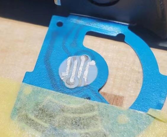

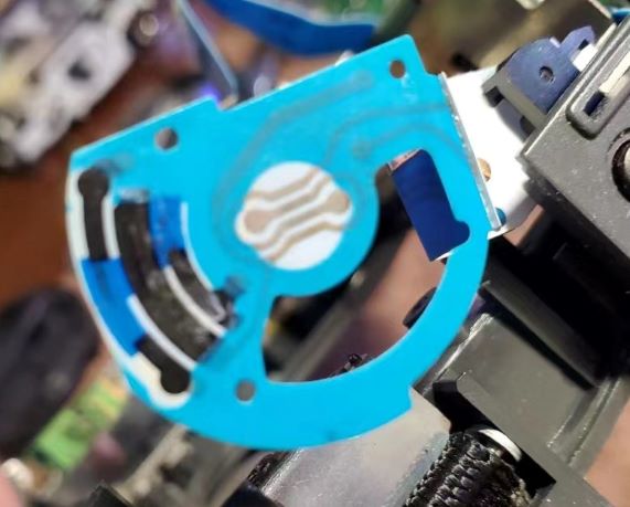

    recently my buddy sent me an old sony TRV900. it said that the Rec button was failure. it do.
    I opened the machine and found that the conductive paint behind Rec button is oxidized. only seems a bit dark but it is totally open with a multimeter.
    Finally it is recovered by repainting the film with sliver paint.
    if you met the same issue hope this could help.

  3. Hello! could you please show me how to do this? i have the exact same problem on the exact same camera! i would be forever greatfull !!! thank you!!!
    Jan 2023
    Shanghai China
    just order some conductive sliver paint to repair it.
    in the market there is a so called: conductive marker pen. it is workable!
    good luck!
