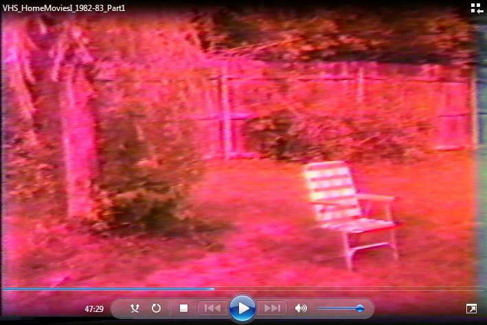

    I've been capturing and converting my family's home video collection on and off for the past 18 or so years. I did all the oldest early 1980s VHS tapes back in about 2005 when I knew very little about the process and used a DV capture card with Sony Vegas.
    I've got a much better setup now and just finished doing dozens and dozens of 8mm and VHS-C tapes, so I wanted to go back and try redoing the VHS tapes. I now use VirtualDub to capture, and have a JVC S-VHS VCR, an ATI600, an ES10 just in case, and am using AviSynth scripts with QTGMC, cropping/masking, etc etc etc, all thanks to this awesome forum.
    I just recaptured my first 2 hour clip on the oldest tape from 1982 (which is only part of a nearly 6 hour long tape...), and noticed some new issues that are not in my 2005 capture. I am assuming that the issues are your typical VHS tape degradation issues popping up after 40 years, but wanted to just double check before I give up to see if it could be anything else (dirty tape heads or something like that?)
    There are 2 main issues I see:
    1. A few clips have a complete red cast over them (see attached screenshot). The red clips start and end where the original video camera was stopped and started, if that makes sense... In my 2005 capture, the colors are fine.
    2. The audio sounds muffled, and if I increase it during capture, I get a high pitched underlying squeal and it still doesn't sound great.
    Fortunately/unfortunately, the video quality obviously looks better overall doing it with my current setup, but the muffled audio makes it very unpleasant to watch and the red parts of course look terrible.
    If it is the tape itself, it probably doesn't make much sense to redo it all. If it could possibly be anything else fixable, please let me know. Thank you!
    PS. I tested another VHS tape and the audio seems fine, so sadly I think it is the tape. I also tried fast forwarding all the way and rewinding, as I read that can sometimes help, but it didn't seem to do anything.

    I can tell you one thing, when tape degrades it doesn't change color, it develops signal noise due to weak RF, anything like white or black comets, scrolling snow stripes, full frame noise, and similar behaviors, It looks like a player issues to me.

  11. Maybe the phase locking with the reference color burst gets intermittently lost. It could be caused by the player or by a damaged color burst (=color reference signal) on the tape.
    Something like this:
    https://www.avartifactatlas.com/artifacts/subcarrier_phase_error.html

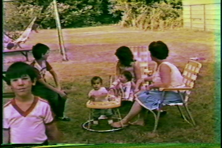

  13. The colors from the new clip can be made similar to those of the older clip:
    [Attachment 69022 - Click to enlarge]
  14. Originally Posted by jagabo View Post
    Wow, it looked so bad to me, I did not even try to color correct. That leads me to wonder if I did some sort of color correction back then but I can’t remember that long ago. I was using Sony Vegas and I don’t think I have the unaltered original captures.
    Did you color correct using AVISynth? If so can you let me know what you used?
    Also, any ideas on the audio?
  15. Yes, I used AviSynth:
    ColorYUV(off_u=-20, off_v=-40)
    ColorYUV(gain_y=70, off_y=-20, cont_u=-100, cont_v=-125)
    This was just a crude adjustment to make it look about like the other video. It could be done in one ColorYUV but I centered the U/V channels first (off_u/v), then adjusted the saturation (cont_u/v) and black/white levels.

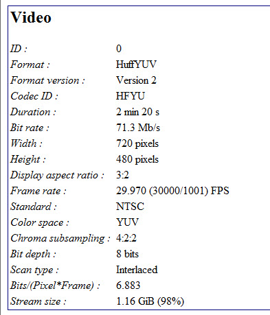

  29. I could live with option 1 (old VHS+ES 10) with a rock solid picture (no wiggling) where the audio is ok, and focus a bit on the video (noise, colors ...). I don't really see that the S-VHS has a significant advantage for this tape regarding recovery of details.
    Edit: Any particular reason why it was captured in RGB rather than YUY2?
  30. Originally Posted by Sharc View Post
    Whoops, I just forgot to change the setting to Direct Stream Copy in Virtualdub when I extracted the short clip to upload here. I had it on Full Processing Mode when I saved avi. I got nervous for a second there that I had something set up wrong! Here is the same clip with direct stream copy. Original capture is YUY2.
