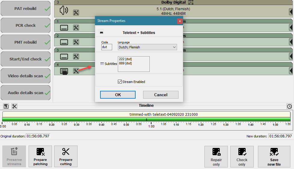

  2. Okay, but ehm.. TS-Doctor manual says
    "Extract Teletext subtitles (srt format)
    If requested, TS-Doctor can convert the found teletext subtitles into the widely used SRT format.
    An additional file with the extension .srt is created for each teletext subtitle"
    How to proceed?
    When buying TS-Doctor, then I would also use its features.
    BTW, in the example above, the teletext is at the bottom, the one with '888'.

  6. I discovered in TS-Doctor, Settings, tab [Stream Select] - option: Teletext - it was set to 'Remove'.
    Changed this to 'Keep'
    Did the cutting again.
    It looks likes this now.
    But .. still unsure how to proceed within TS-Doctor.

  8. Originally Posted by Nikse View Post
    Try Subtitle Edit.
    Use File - Open... Choose .ts file.
    Thanks!
    Solved, with Subtitle Edit after opening the last version of the .ts file created with 'Teletext: Keep' in TS-Doctor.
    The first try, where Teletext=Removed, no results.
