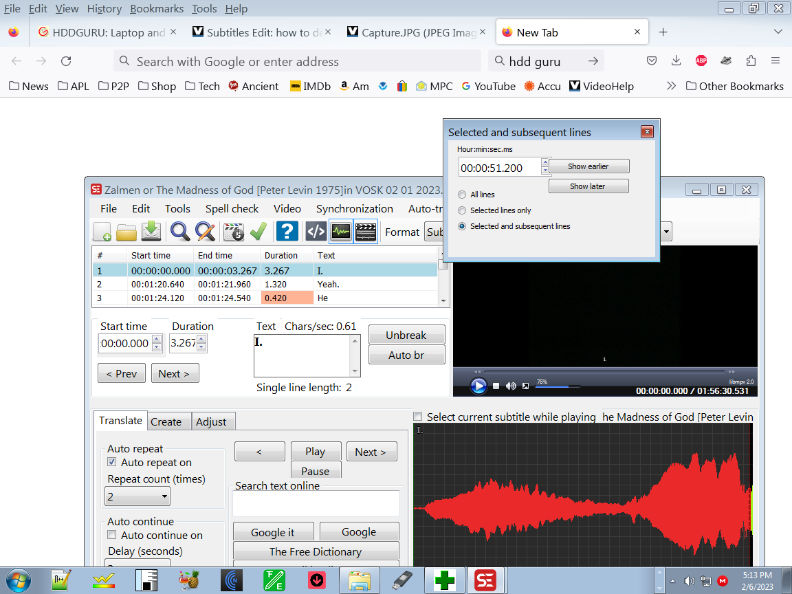

Multi-select all the subs you want to delay. Then apply the 27 second delay to the selected subs.
What worked for me was:
Stay in the Synchronization tab. Use option one and use the last selection (third further down.) That worked for me a couple times, thanks to a previous answer here in videohelp.
