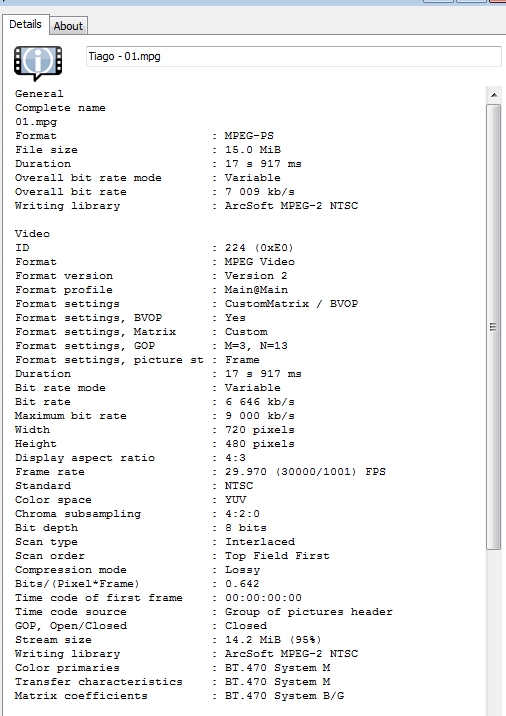

    I have a mini dv, but it doesn't play normal on my cameras, its on pal, the video is blinking, what should I do?
    Sent a video file of it.

  6. Originally Posted by Litaiff View Post
    Anything wrong here?
    Very much. You captured the DV through some box that converted it to mpeg and messed up the frame rate in the process. Mini dv should be captured with firewire for a 1:1 transfer.
    Basically, all the things jagabo pointed out.

    @Litaiff, DV is a digital format. You are converting it into analog, then converting it back to digital with whatever A/D converter you are using and encode it with ArcSoft into MPEG-2. This is the workflow for analog video. Although I like ArcSoft software, you will get much better quality if you just copy bytes from the tape directly into a computer file via Firewire with no modifications. The operating instructions should explain this.
