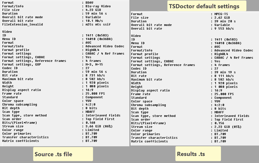

    TSDoctor:
    Gave a try with a source .ts source file being 4.5GB, being 1 h and 3 second, 1:00:03
    Removed leading and trailing stuff save the file to a new .ts file - playback shows only 39:21 is left - so, some 20 minutes of commercials.
    New file size 2.8GB
    I did not go into TSDoctor settings, I used it as it is.
    I see some change in 'Format" and "Overall BIT-rate", but .. I am not an expert, so I do not know if this is really important.

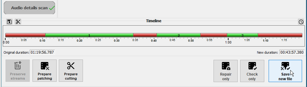

  5. Any suggestion as to how to proceed from this point?
    When I click on Save new file, the new file still shows what is marked in red.
    later:
    when I retried later, it worked.
    am considering to purchase TSDoctor
