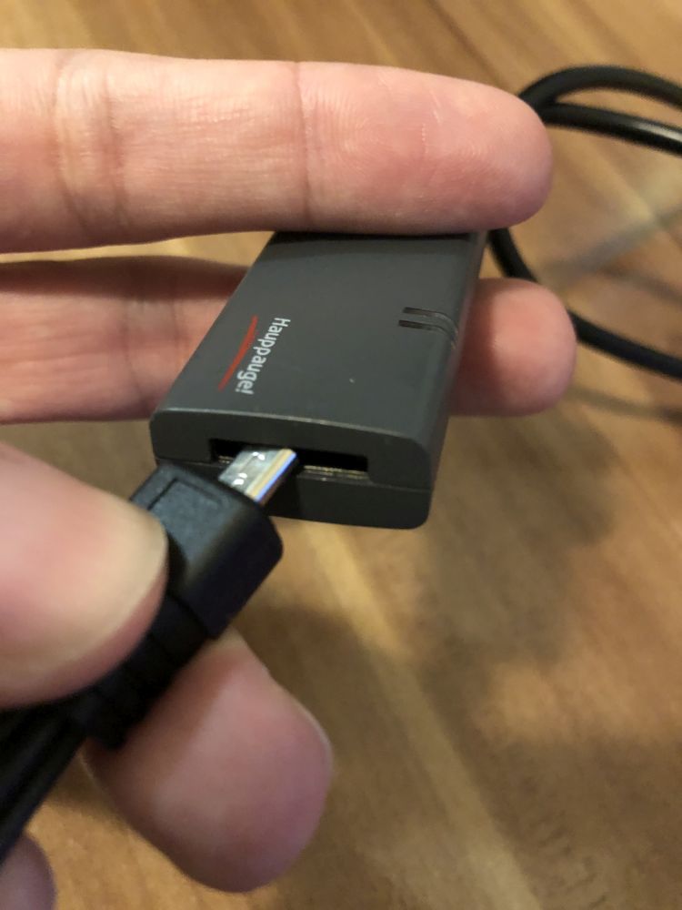

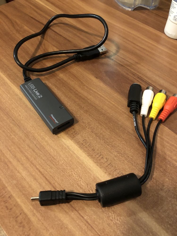

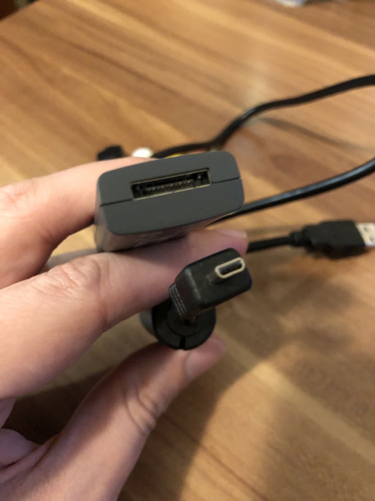

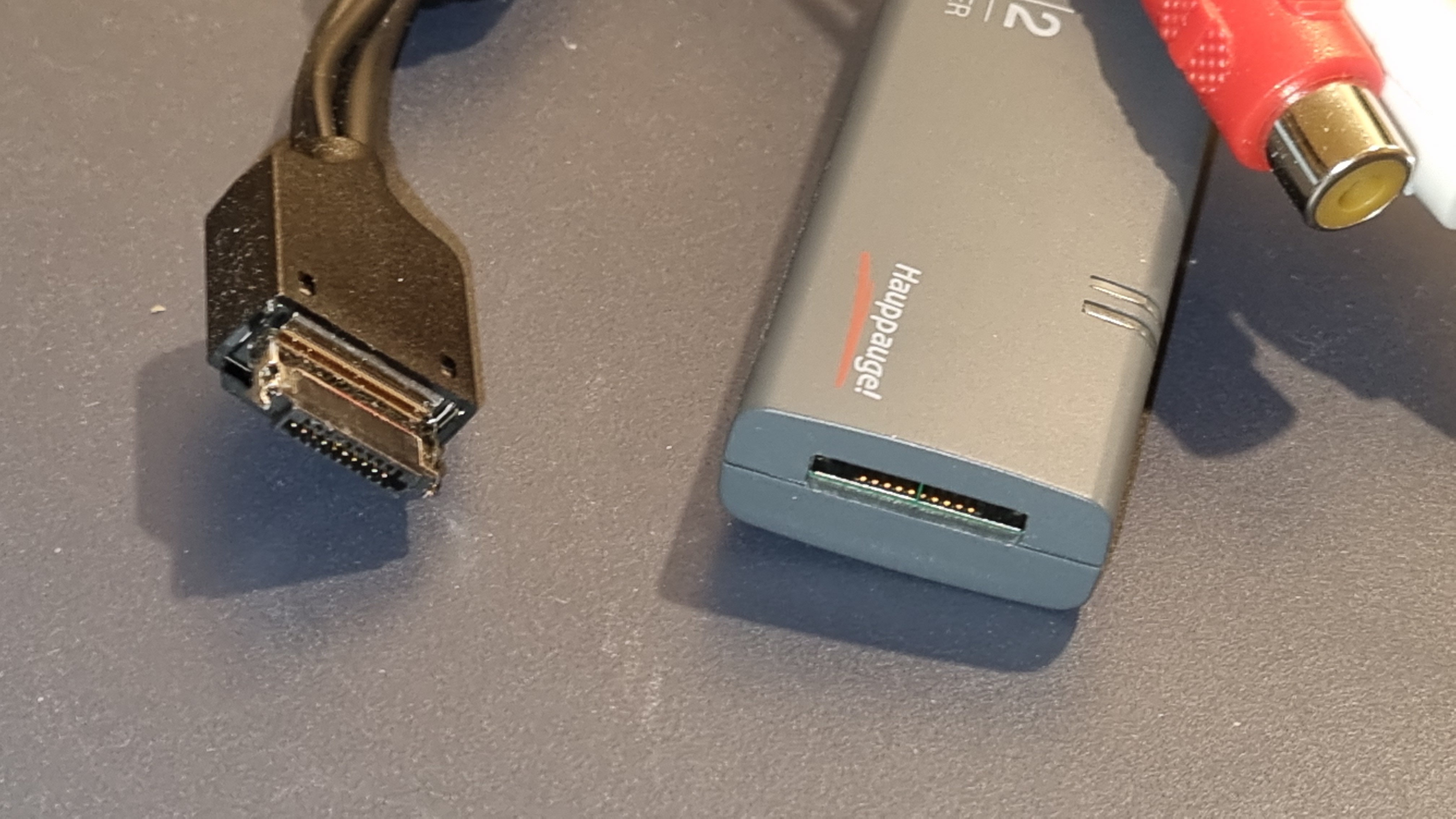

  21. So i just received my Hauppauge from Amazon? I think its not not supposed to look like this?
  22. Member
    May 2005
    Australia-PAL Land
    You'd be right! Here's the real McCoy:
    [Attachment 69119 - Click to enlarge]
    I bought mine from the Hauppauge website.
  23. Originally Posted by Alwyn View Post
    Hi Alwyn, thanks a lot. Youre the bestest. I talked to Amazon and they will send a replacement soon. They have official Hauppauge goods on their Amazon site (seller is Hauppauge) so not sure what happened. If the replacement will be wrong as well, I will return it too and buy it via official site (not sure from which country they will send the goods though).
    Just a quick q, on my Hauppauge token, it says its made in Indonesia. Is yours made there as well? or do you think they sent me a knock-off?
  24. Member
    May 2005
    Australia-PAL Land
    Yes, mine's made in Indo as well. Top line says 122000 LF Rev C1 2322.
    Mine came from Singapore (to Australia).
    Good luck with Amazon, it's rather odd, I must say. Pretty basic stuffup, that's for sure.

    Hi Alwyn,
    i think im all setup hardware-wise. I tried to put everything into works and read your other posts such as these:
    https://forum.videohelp.com/threads/401570-Hauppauge-USB-Live2-vs-IO-Data-GV-USB2
    I'm in testing mode, so I have installed Canopus Picture Controller. For Video Capture, I have temporarily installed Hauppauge Capture till i test and find the best video capture. However, I am receiving no signal in Video Capture and when I run Picture Controller, I am getting an error "ADVC-300 can not be found". As discussed previously, I am not connecting ADVC-300 to PC via firewire, but via USB using Hauppauge USB-Live2. So it seems the PC is trying to find Canopus via firewire which it cant.
    I tried to see my network settings but came out clueless. How are you finding your Canopus on your PC without using firewire, please? Or is this merely a video capture setting issue?
    [Side note: I honestly have very little idea what I'm doing, so if I'm asking dumb questions, feel free to correct me. I am not sure how many softwares I need to for video capture. Do i need both Canopus Picture Controller and ProCoder? I installed Hauppauge Capture, but I will not need winTV10 if i will be using other softwares to record videos, correct?]
    Thank you very much for your time and help, appreciate all your help.

    With the Hauppauge USB-Live 2:
    - install the appropriate drivers
    - use AmarecTV and capture YUV 4:2:2 format with a lossless codec
    - provide to the card a Y/C signal through a S-Video connection, because its comb filter is poor
    - be sure to have a lineTBC correction in the workflow (in the VCR or additional device)

    Hello Lollo,
    thanks for your reply. You are an angel.
    - I now installed both Hauppauge Capture and WinTv which also installed the drivers during the installation.
    - I downloaded AmarecTv. However, i see its settings in NTSC only, while I record PAL. Is there a way to change it to PAL settings, please? Site also says I will need AMV Video Codec which is $30. Is this correct? Or lossless codec can replace it?
    - "provide to the card a Y/C signal through a S-Video connection, because its comb filter is poor" I unfortunately do not understand what this means. Would you be able to elaborate, please?
    - I have Panasonic FS 200 and Canopus ADVC-300 which both have TBC, so i should have double-TBC overkill enabled.
    I tried to remove Canopus from the flow and connected PC directly to VCR via output cables. It gave me A-HA moment, as I have realized that I was streaming S-video output but I was watching Composite channel (big A-HA moment). And I have realized that I have plugged red and yellow RCA cables, not red and white (second A-HA moment).
    This is the result:
    1. VCR directly to PC: I now receive both audio and video output, however, video output is black-and-white.
    2. VCR through Canopus into PC: no signal (ill have to set-up AmarecTv)
    Thanks a lot for any inputs. These cables got my head spinning...

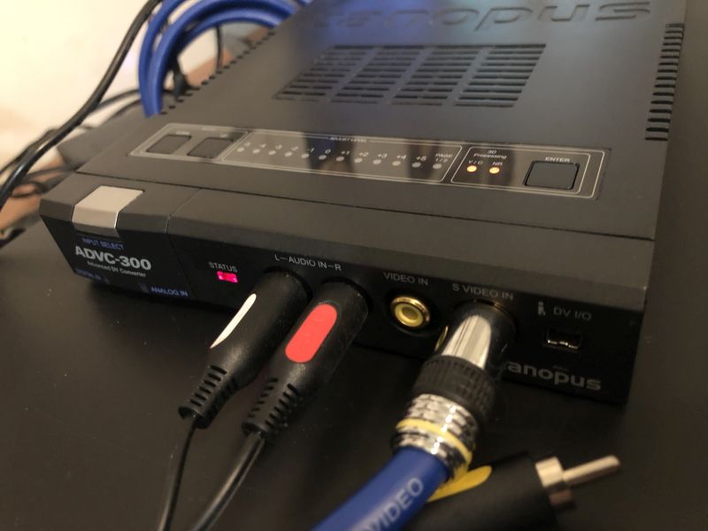

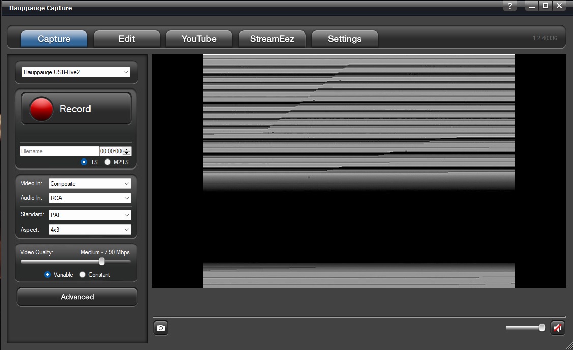

    Hi Alwyn,
    thanks a lot for your explanations. I have now successfully installed both AmarecTV and codecs and am able to record lossless in avi format
    Regarding the signal, it is trouble-some though. When I connect PC directly to VCR using Hauppauge USB-Live2, the video is going through but still black & white (btw, my VCR's TBC is doing great job, makes me wonder if I needed Canopus at all).
    When I plug Canopus in the flow, Canopus status lights red, there is no light on Analog/DV input (screenshot attached). Status light is red constantly even if i dont play any tape so I do not think it is a MacroVision issue?
    I have PAL VCR and Hauppauge should support PAL as well, not sure where the B&W signal comes from. I've been going through historical VideoHelp topics but they mainly talk about NTSC issue, not PAL. Would you know what could cause this, please?
    Thanks a lot in advance
