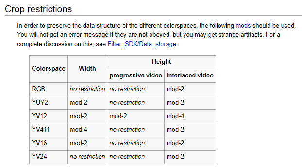

  10. Originally Posted by Alwyn View Post
    My cropping gives 687x559.
    Not sure if this is a good idea. For cropping one should follow these rules I think:
    [Attachment 69007 - Click to enlarge]
    http://avisynth.nl/index.php/Crop
    I usually crop mod4 to be on the safe side.
    May 2005
    Australia-PAL Land
    @Sharc, hold ya horses, I didn't suggest one should use those values for the final product, I just put them up to show what I surmised Selur had done.
  12. No offense, I understood it as your proposal for cropping. So I thought a notice would do no harm
