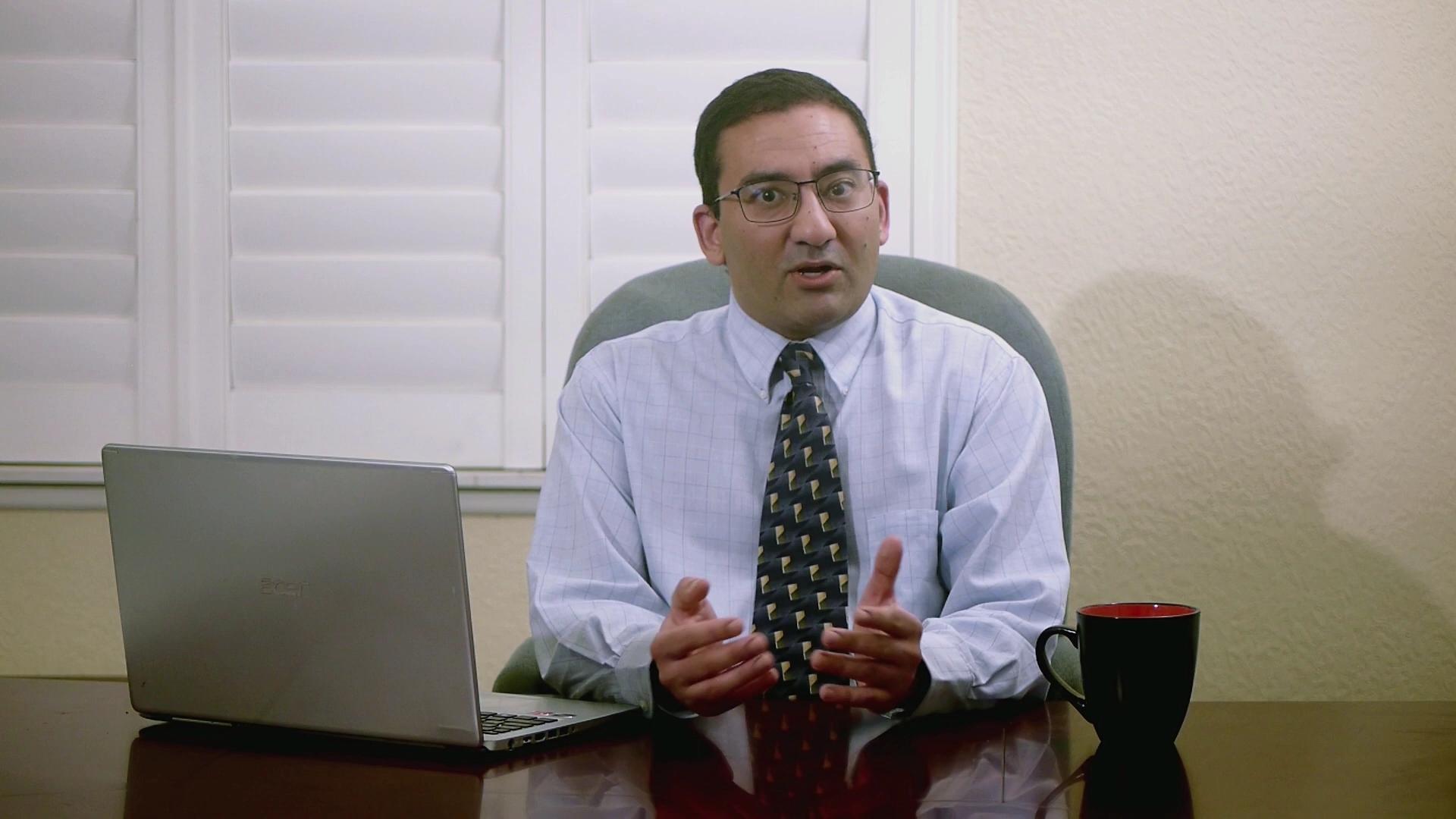

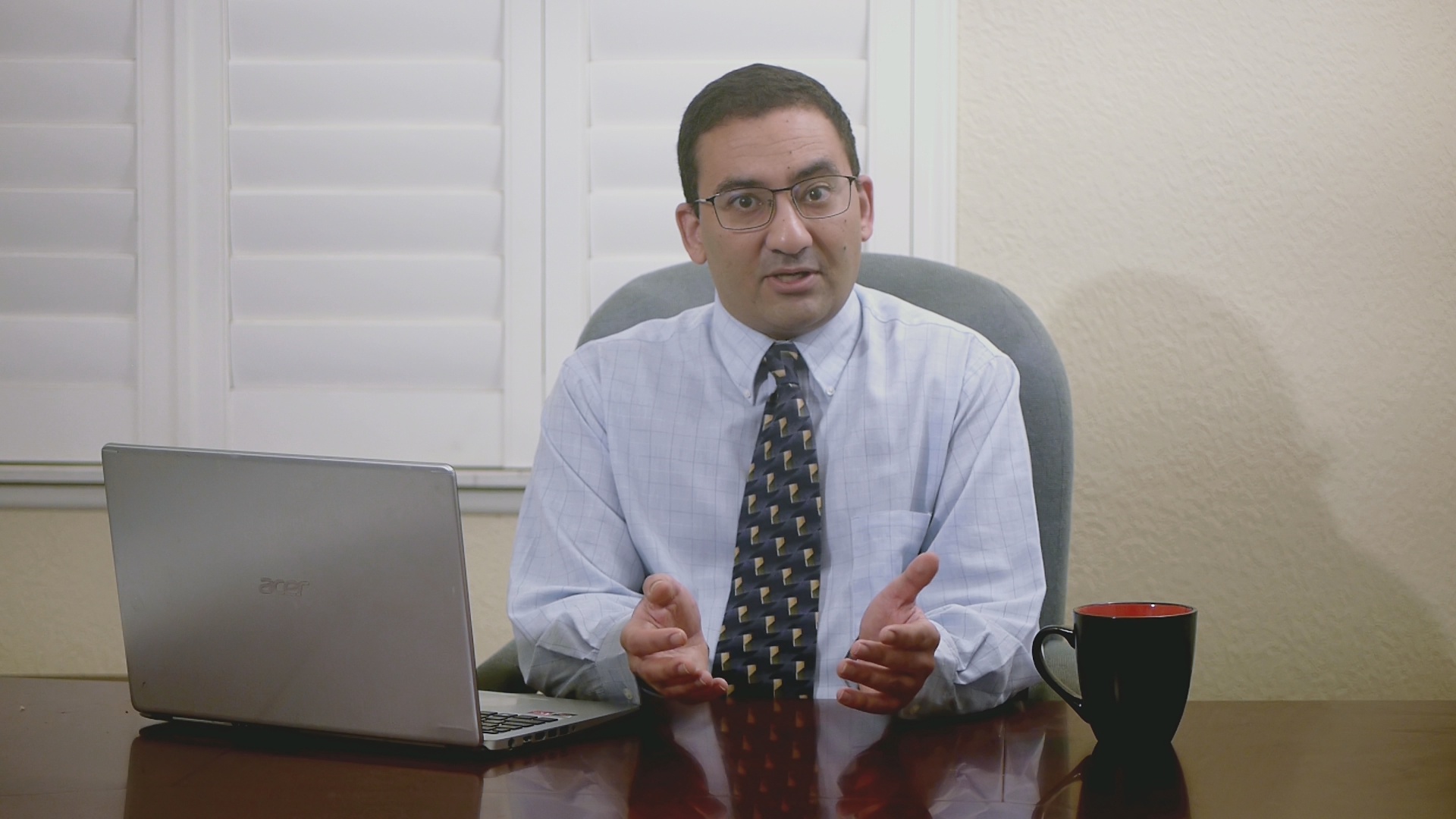

    Personally, I would go a touch greener and try to shadow off some of the endless expanse of wall (see rough example below) but you can probably get away with the barely noticeable strobing.
Name:	VD2 - 1080p.mp4_snapshot_00.00.000.jpg
Name:	VD2 - Revised.mp4_snapshot_00.00.007.jpg
    What did you use to add that green color? When I just go into a video editor and boost the green, I'm not able to achieve the same effect. The skin turns green. The way you did it preserves the skin tone.
    Let me know.

  10. Originally Posted by DavidS View Post
    Here is what happened when I tried to boost the green in the highlights using Sony Vegas.
    First, the skin tones are not in the highlight range, the wall is. You need to drop deeper -- into the midtones.
    But what I did was simply chose the slats on the window shutters to set the white balance. (I used After Effects, but Vegas has similar functions.) If the first selection doesn't look right, there are various light purples on the shutters to choose from -- try another. This results in a curved rather than linear correction.
    I also boosted the contrast slightly using all channels of the RGB curve.
    It works fine on video. Another thing you can do on video is to create a rough, soft-edge mask around the speaker and replace the background with a still frame which eliminates the rolling light flicker. (But again, it's so subtle at real speed that it's not likely to be noticed.) I was a little sloppy with the mask towards the end of the clip and his double hair shows through. That's easily fixable by making the mask slightly wider.
