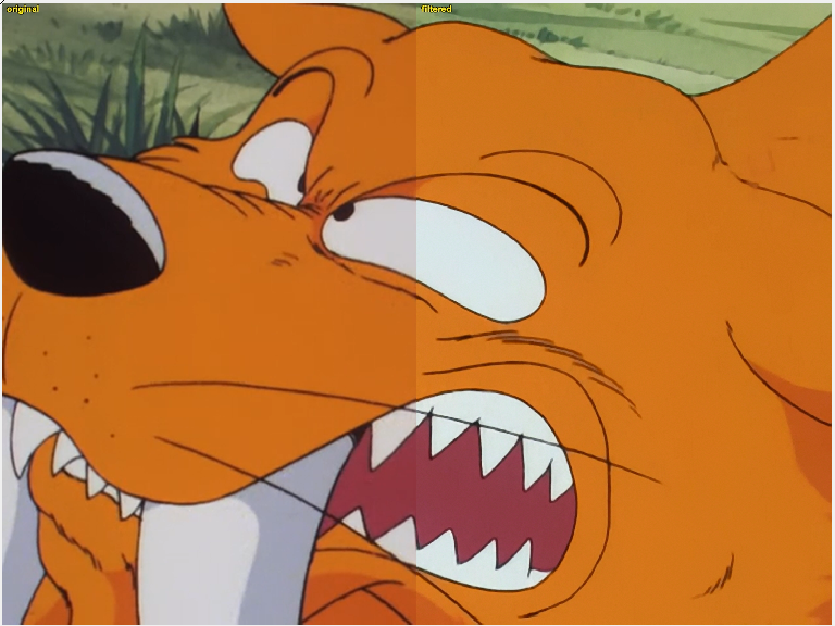

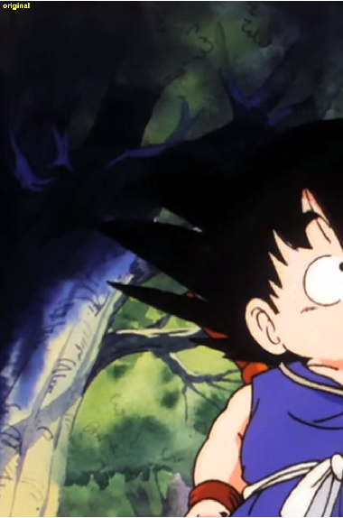

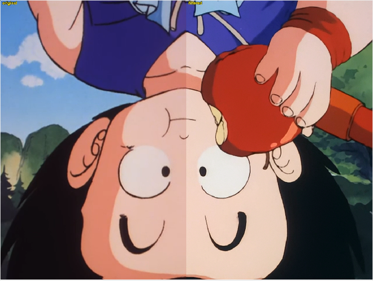

    The colours I get at the moment are like the below ones
    The left side is the original version, only upscale via Lanczos to compare, with the above filter
    [Attachment 68886 - Click to enlarge]
    [Attachment 68887 - Click to enlarge]
    [Attachment 68888 - Click to enlarge]

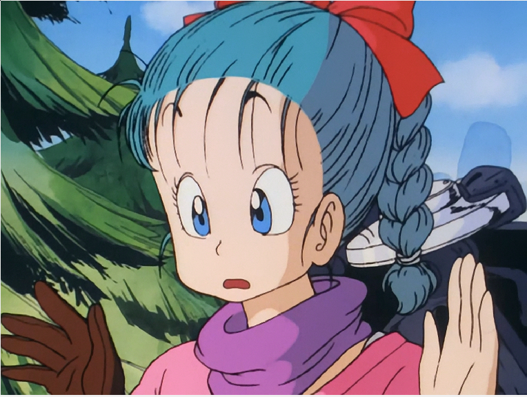

    The below picture is the filtered version
    [Attachment 68889 - Click to enlarge]
    I think I was able to get rid of the "grey haze" and some of the "red tint", but I think there is space for improvement.

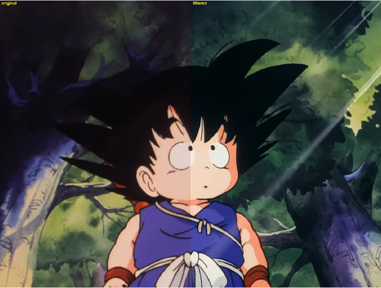

  3. Here's how I approach levels and white balance with RGBAdjust(). First I blur the image (to reduce noise) and find something large (to avoid color contamination from nearby areas) that should be black. The character's hair is the darkest thing in the shot and in anime is likely to be full black. I used an RGB picker to read the R,G,B values 9, 6, 9. So adjust the black level you need to subtract those values:
    RGBAdjust(rb=-9, gb=-6, bb=-9)
    After that I look at the white levels. The character's eyes probably should be full white. They're not very big but the best we can get here. The RGB values (after the above subtraction) are 217, 203, 194. Since those probably should have all been 255 your can adjust them with:
    RGBAdjust(r=255.0/217.0, g=255.0/203.0, b=255.0/194.0)
    If you think 255 is too bright, you can use lower numbers in the numerators.
    When your done with adjustments you remove the blur.
    ImageSource("DB.png")
    crop(0,0,width/2, height) # just the left half of the frame
    #Blur(1.4).Blur(1.4).Blur(1.4) # used when analyzing RGB values
    RGBAdjust(rb=-9, gb=-6, bb=-9) # adjust black level
    RGBAdjust(r=255.0/217.0, g=255.0/203.0, b=255.0/194.0) # adjust white level and balance
