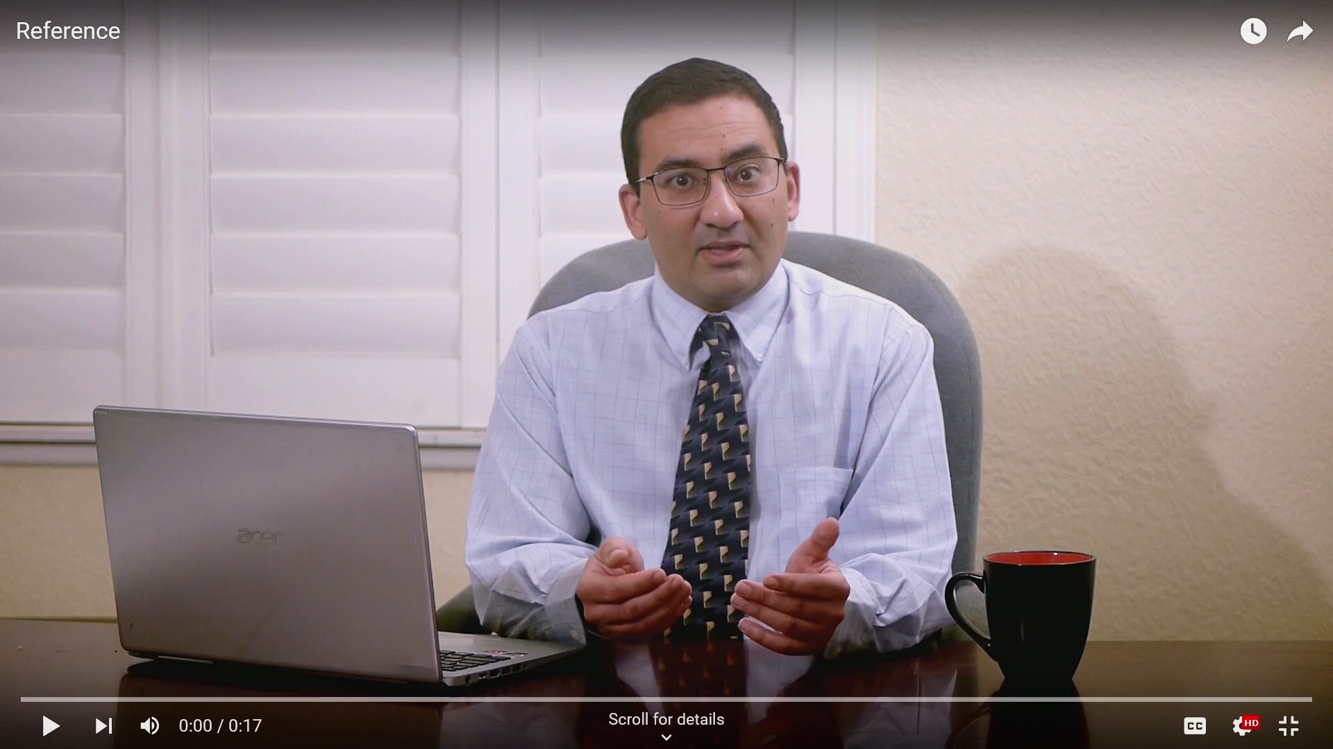

    I have a video that I'm editing for YouTube and the color in the video looks a little off. However, when I do a screengrab from the video or save an image from the video using VirtualDub or AviDemux, the colors look perfect when viewing the still image.
    I want the colors in the video itself to match the colors I get from a screengrab of the video.
    Why are the colors in the saved image from the video being interpreted differently than the way the video players play the video and what changes should I make to the video to make the colors match up?
    I hope the way I phrased this makes sense. I can post some samples if needed to better understand the situation.

    How are you checking the colors ?
    The second entry "same" refers to the component range, full vs limited . Most videos will be limited range, so it should be "same"
    It makes an immediate difference in the preview for me, and the encoded video has colors shifted

    I made a video from the "worse" image in this thread, using 709 to convert back to YUV . It's attached below as "worse.mp4"
    https://forum.videohelp.com/threads/408373-Differences-in-color-between-video-and-save...eo#post2679289
    I went through the vdub2 aliasformat filter to convert in YUV to 601 , and flagged it as 709
    This is what it looks like when it's converted to RGB for display using 709 (it should look like that in a media player, or YT in firefox; but it should look "wrong" in vdub classic or the way you have edge setup for YT)

    It worked. Thank you. The problem was that I forgot to set VD to decode the video using Rec 709. Since it defaults to decoding in Rec 601, when I added the alias filter it didn't change anything. After I set it to decode in Rec 709, then the proper conversion was done.
