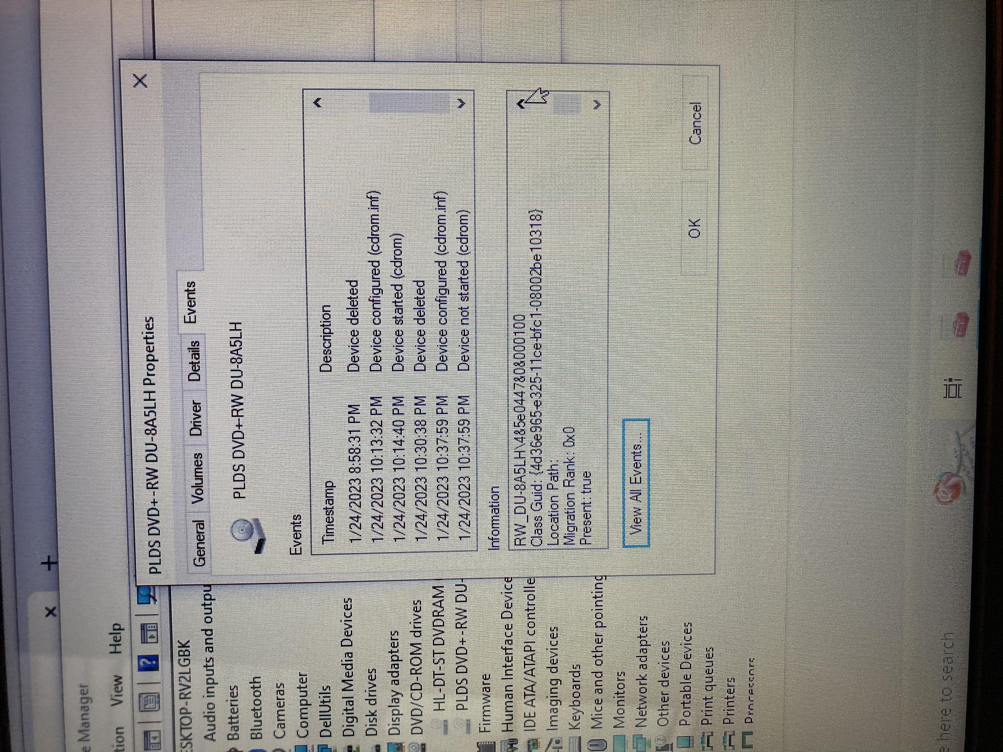

  1. I have a Dell Inspiron 15 3000 series laptop with a PLDS DVD+-RW DU-8A5LH DVD burner. I’m running Windows 10.
    Last night the burner stopped working. I burned a few coasters and got error messages that the device couldn’t be found. I uninstalled it and rebooted my computer. The drive reinstalled itself, but when I just tried to use it, it has disappeared. I can only find it when I open Device Manager and choose the option to Show Hidden Devices. When I look at the Properties tab, I see the info in the attached pic. Anyone have ideas on how to get this working again?
    Thanks.
    [Attachment 68853 - Click to enlarge]
  2. UPDATE: My laptop is now recognizing the drive, but when trying to burn a DVD with ImgBurn, the burner starts up like it is going to burn. The “Time Elapsed” counter starts, but after about three minutes of no progress, the burn fails due to an I/O error. Any ideas?
    Thanks.

    Probably HW error, although you should bring up the driver/driver details and post the screenshot

  5. Delete all hidden devices related and reboot.
    Mar 2008
    According to this PxHlpa belongs to Sonic software. I'd uninstall it, make sure that entry dfisappears and see
    if the drive is now visible
    https://www.file.net/process/pxhlpa64.sys.html
