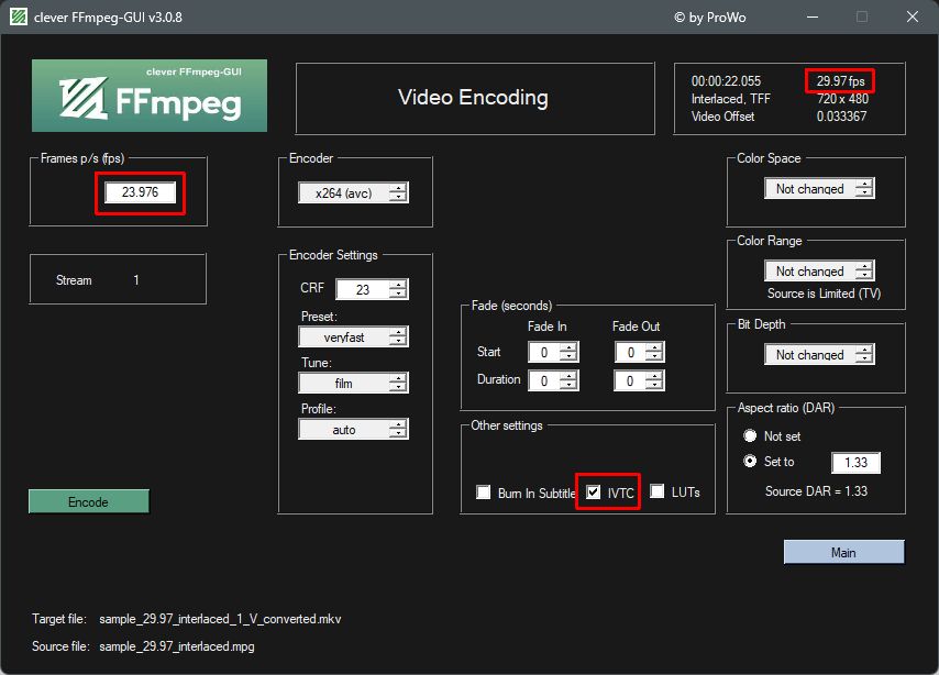

You can also make your life easier.
Use clever FFmpeg-GUI, load your 29.97 fps Video, click main, click encode Video Stream, click keep resolution (in case you want mantain it), set the IVTC Box, you'll see the fps field is changed to 23.976, click encode. Done.
[Attachment 68908 - Click to enlarge]
You'll find your new 23.976 fps progressive Video into the target folder.
If your source file is interlaced, yadif deinterlacing is applied. The colorspace is not changed.Last edited by ProWo; 27th Jan 2023 at 09:37.
