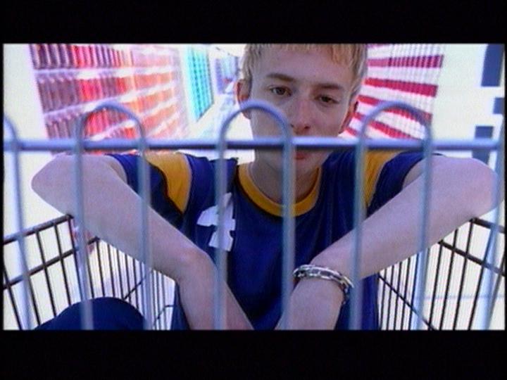

  1. this is the best version i could find. radiohead's videos from "the bends" era tend to be the least good looking ones when it comes to video quality and this video is probably the worst looking one. is there a way to save any of it? Image
    [Attachment 68730 - Click to enlarge]

    It may help if you were to indicate what you consider is 'wrong' with the sample.
    How does this compare to the version on YT ?
    I do note that the YT version is 25 fps whereas you appear to have a NTSC dvd source. However, the official dvd source, according to Amazon, is PAL.

  4. It may help if you were to indicate what you consider is 'wrong' with the sample.
    blending (also present on youtube, not present on some other clips from the dvd), the sharpening(?) halos
