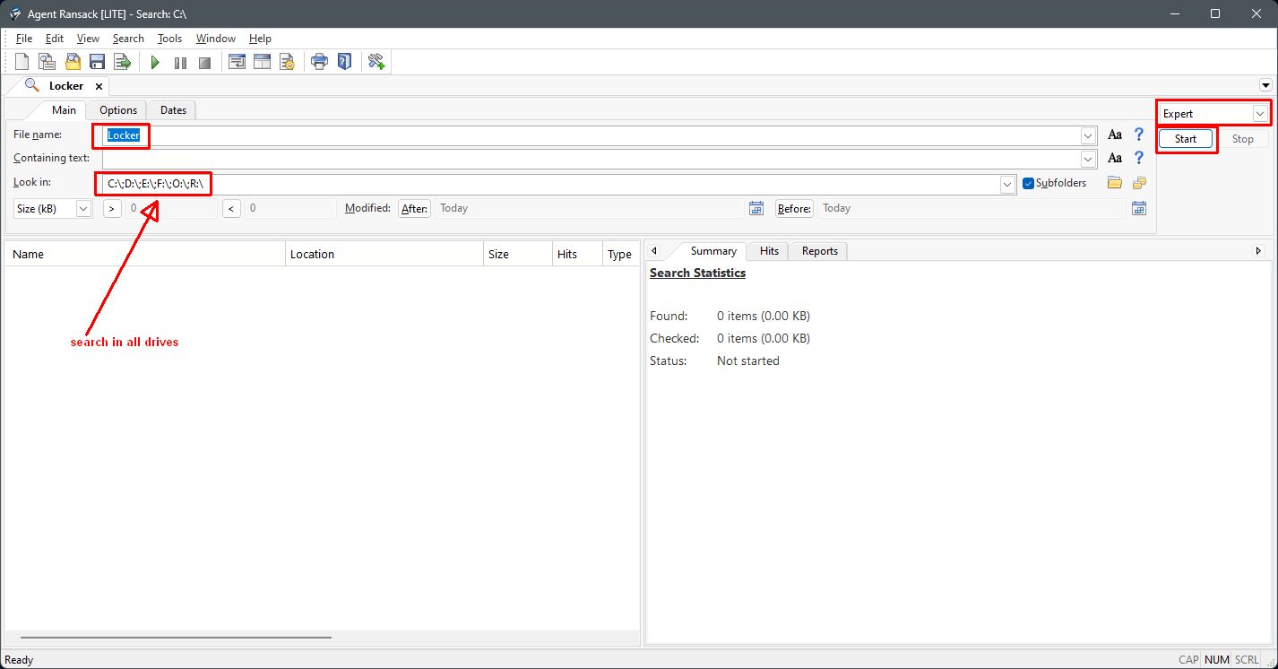

    The Locker Folder isn't vanished, is only hidden.
    You can search for it with AgentRansack
    https://www.mythicsoft.com/agentransack/download/?src=upd
    Download the portable version for your system (x86 or x64).
    [Attachment 68710 - Click to enlarge]

  6. Use Agentransack (DL link above).
    It finds hidden files/folders too.
    Search for Folderlocker.bat
    The folder where it's in is the main folder.
    Then search for Locker.
    This is the hidden folder with your files.
    Move/copy it into the main folder.

    Ok, the search for Folderlocker.bat on my C: laptop drive found nothing.
    The search for Locker on the same found everything but.
    However, a search for Folderlocker.bat on the E: external drive (where all of this took place originally) found it, of sorts.
