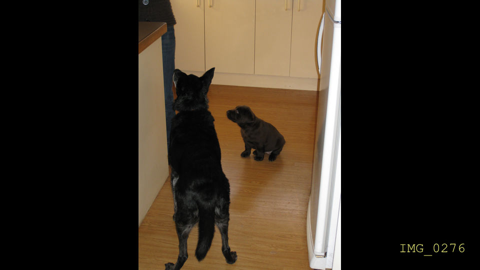

  6. Member hydra3333's Avatar
    Oct 2009
    Australia
    Thanks ! Great stuff !
    Fiddling with it now to work on my system...

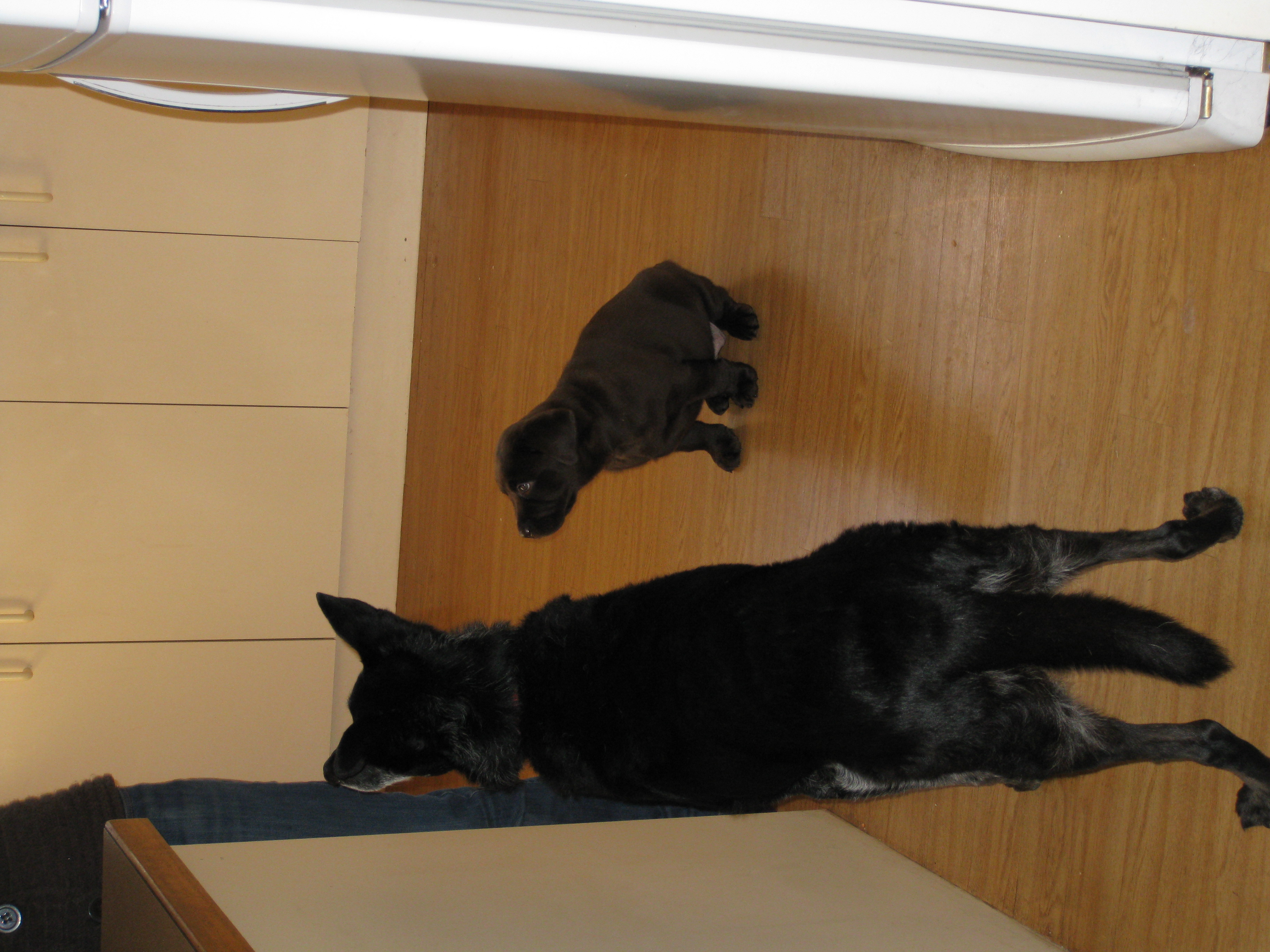

    A couple of funny things :
    1. UPSIZE_KERNEL = 'Lanczsoz' causes it to crash, had to resort to Spline36 until I figure out why
    File "src\cython\vapoursynth.pyx", line 2415, in vapoursynth.Plugin.__getattr__
    AttributeError: There is no function named Lanczsoz
    2. some of my images appear to have EXIF data like "Orientation - Right top" etc set,
    which is some sort of rotation required to display the image properly ...
    irfanview respects it and displays properly
    ffprobe -show_frames shows "rotation=-90"
    however I can't find how to set core.ffms2.Source to respect it.
    hmm, imagemagick doesn't rotate either
    Not complaints, just items of interest to look into:
    - number 1 I can live with until I discover what's happening
    - number 2 is a tad less liveable, so I'll keep fiddling

  9. 2. some of my images appear to have EXIF data like "Orientation - Right top" etc set,
    Can rotation be detected by mediainfo? If yes,it could be implemented too, I have things set for mediainfo here, never parsed ffprobe in python, that would be longer shot.
    Or actually could imwri source detect rotated image?
    clip = core.imwri.Read([str(path)])
    https://github.com/vapoursynth/vs-imwri/blob/master/docs/imwri.rst
    download dll: https://github.com/vapoursynth/vs-imwri/releases/tag/R2

            if   value == 3: clip = clip.std.Turn180()
            elif value == 8: clip = clip.std.Transpose().std.FlipVertical()
            elif value == 6: clip = clip.std.Transpose().std.FlipHorizontal()
            if save_rotated_image and value in [3,8,6]:
                #rotation degrees are in counterclockwise direction!
                rotate = {3:Image.ROTATE_180, 6:Image.ROTATE_270, 8:Image.ROTATE_90}
                image = image.transpose(rotate[value])
                path = path.parent / f'{path.stem}_rotated{path.suffix}'
                image.save(str(path))
        image.close()
        return clip

    Trying to display parts of the image name to the bottom right, closer to the bottom than core.text.Text puts it, and blended in like an opaque logo.
    this_clip = core.text.Text(this_clip, subtitle_path, alignment=3, scale=1)
    That works, however
    this_clip = core.sub.Subtitle(clip=this_clip, text=r'2222')
    aborts with
    Property read unsuccessful due to out of bounds index but no error output: clip
    no matter what I try.
    https://amusementclub.github.io/doc3/plugins/subtext.html
    Can't seem to get the margins in Assrender to do what I want, hmm, it always appears at top left regardless of left=,top= etc
    https://github.com/AmusementClub/assrender
    this_clip = core.assrender.Subtitle(this_clip, subtitle_path + " with T=-500", colorspace="BT.709", top=-500)
    Suggestions welcomed.
  26. Member hydra3333's Avatar
    Oct 2009
    Australia
    Never mind
    Tried aegisub-procles in an ubunbtu VM to see what .ass parameters did what.
    Discovered what some of the style= settings did and can be used in the "assrender.Subtitle" call per https://github.com/AmusementClub/assrender
    Could try ass tags in the text= however will try a custom style= since that's more in your face.
    Also nice:
    start, end: Subtitle display time, start frame number and end frame’s next frame number, it will trim like [start:end], default is all frames of clip.
    which hopefully means I can use frame numbers in "assrender.Subtitle" instead of having to calculate timecodes.
    From aegisub fiddling, the style string from that looks like:
    [V4+ Styles]
    Format: Name, Fontname, Fontsize, PrimaryColour, SecondaryColour, OutlineColour, BackColour, Bold, Italic, Underline, StrikeOut, ScaleX, ScaleY, Spacing, Angle, BorderStyle, Outline, Shadow, Alignment, MarginL, MarginR, MarginV, Encoding
    Style: h3333,Arial,15,&H00FFFFFF,&H000000FF,&H00000000,&H00000000,0,0,0,0,100,100,0,0,1,0.9,0.5,3,1,1,1,1
    which may, I hope, be recycled to do the trick:
    style="Arial,15,&H00FFFFFF,&H000000FF,&H00000000,&H00000000,0,0,0,0,100,100,0,0,1,0.9,0.5,3,1,1,1,1"
    or perhaps with sans-serif per https://github.com/AmusementClub/assrender
    Cheers.
    edit: yes this worked a treat:
    this_clip = core.assrender.Subtitle(this_clip, text_subpath_for_subtitles, style="sans-serif,18,&H00FFFFFF,&H000000FF,&H00000000,&H00000000,0,0,0,0,100,100,0,0,1,0.9,0.5,3,1,1,1,1", frame_width=TARGET_WIDTH, frame_height=TARGET_HEIGHT, colorspace=TARGET_COLOURSPACE)

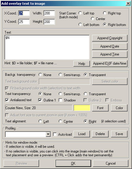

    - Check "Canvas Size" in the middle column and click on "Settings". Select "Method 2" and set the same dimensions you used for resizing (it adds black borders).
    - Check "Add overlay text" and then click on "Settings". The settings I used are in the screenshot below. The text is based on the file name but you can use fields from EXIF or IPTC data if you want to.
    - Click Okay so you're back in the main batch conversion window. Add your images and batch convert them. They'll be given sequential numbers as their file names.
    [Attachment 68766 - Click to enlarge]
    Below is the result of converting one image. The original was named "IMG_0276.jpg". The output was a bitmap but I resaved it as a jpg to upload it here.
    Before:
    [Attachment 68768 - Click to enlarge]
    After:
    [Attachment 68770 - Click to enlarge]
    Once all the images are batch converted, open the first one in VirtualDub2. If they're sequentially numbered (only numbers as the file names) it should open them all automatically. Under the Video menu change the frame rate to 0.5 FPS (for each picture to display for 2 seconds). Convert to whatever format you prefer. Maybe something losssless if you want to open the output video with a script and re-encode it with a different encoder etc.
