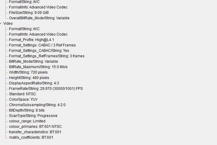

  10. Image
    [Attachment 68698 - Click to enlarge]
    I am trying to do a BD of personal older home movies from miniDV for starters and this is what mediainfo gave me. This is from one of the video files demuxed for BD Wizard.
    At that resolution, the Blu-ray spec requires interlaced video. Your video is progressive.
    [Edit] DV AVI is interlaced. You may want to start over with a DV AVI file if you can. TMPGEnc Authoring Works can import some types of DV AVI and convert it for authoring. If TMPGEnc Authoring Works can't import it, try importing your DV AVI file into Cyberlink Power Director, which also has a free trial. Cyberlink Power Director is an editor but it can also author simple Blu-ray.

    i would have gone from miniDV to captured avi to mpeg-2 720 interlaced. it's allowed under the blu-ray spec. the free version of Blu-Disc Studio Lite can make bd's if you don't need involved menus.

    As usually_quiet mentioned, demux will not help. You need to re-encode the video. I recommend using x264 (you can try this UI https://blu-disc.net/download/EncoderUI.rar)
  20. Originally Posted by mikey128v View Post
    I am trying to do a BD of personal older home movies from miniDV for starters and this is what mediainfo gave me. .
    it should be in DV codec 25Mbps with WAV audio, the video should be interlace not progressive. The capture method you used is what messed it up. BD spec is very strict.
