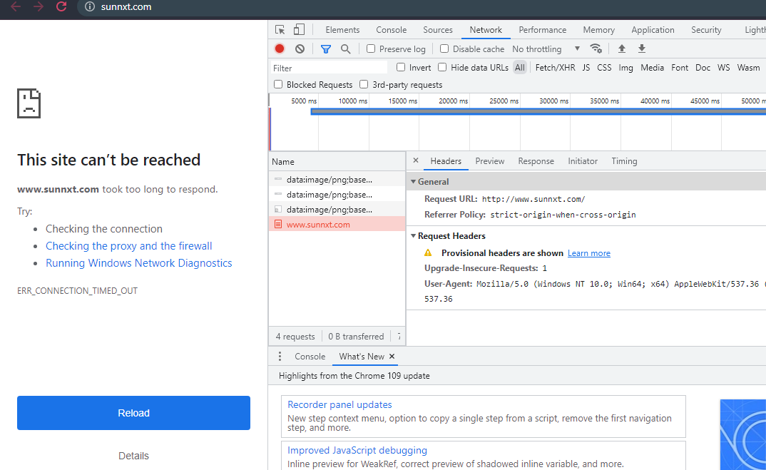

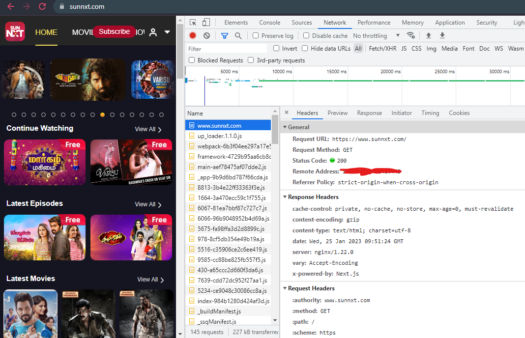

  28. unable to connect.
    by using chrome and type the sunnxt then it loads
    [Attachment 68837 - Click to enlarge]
    by clicking the url(www.sunnxt.com) in videoforum not working
    [Attachment 68838 - Click to enlarge]
  29. The site now says
    403 Forbidden
  30. works with Indian vpn
