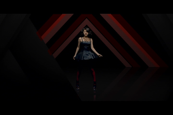

    I recently got hold of some masters of SD music videos and I'm trying to fix any issues they came with. I don't want to go on a rant about something but some of them are very difficult to deal with, such as interlaced encoded as progressive or straight up mixes of interlace and telecine.
    The one I'm asking about has none of these issues whatsoever, it's a 720x480 29,97i ProRes file. From what I can tell it uses 3:2 pulldown or some sort of it so I tried my luck with TIVTC. The thing is, no matter how many settings I change (I've spent 2 good hours of reading the docs and googling) I still end up with orphaned fields. I also tried deinterlacing and then removing the duplicate frames but the problem still persists. The only clean result was by using Premiere Pro and forcing a 23.976 progressive output, although it looks like crap (I assume it's because Premiere doesn't interpolate the missing fields thus halving the vertical resolution = looks pixelated). But what fascinates me is that Premiere catches the fields spot on, no duplicates, no orphanages and no combing at all.
    I tried reproducing the Premiere workflow in other programs (Handbrake, Staxrip) but I can't for the live get a similar result. All my attempts at inverse telecine didn't succeed, it always ends up looking like this, no matter what pp values I specify in TFM():
    [Attachment 68666 - Click to enlarge]
    Maybe the problem is that my TDecimate values are off, but I tried a lot of different settings so I think I'm just lost..
    Can someone with knowledge in this area please help me create a script that will take care of this problem? Or is the file itself the culprit, thus not really fixable without spending an insane amount of time on it? I also attached the Premiere output file to demonstrate that it takes good care of these fields so it must be an error in my script or TIVTC in general I guess.
    Here are my settings, although as I said I've tried multiple modes and values:
    TDecimate(mode=0, cycle=5,cycleR=1)
    TFM(mode=4, pp=6, mi=40, slow=2)
    Thanks in advance
