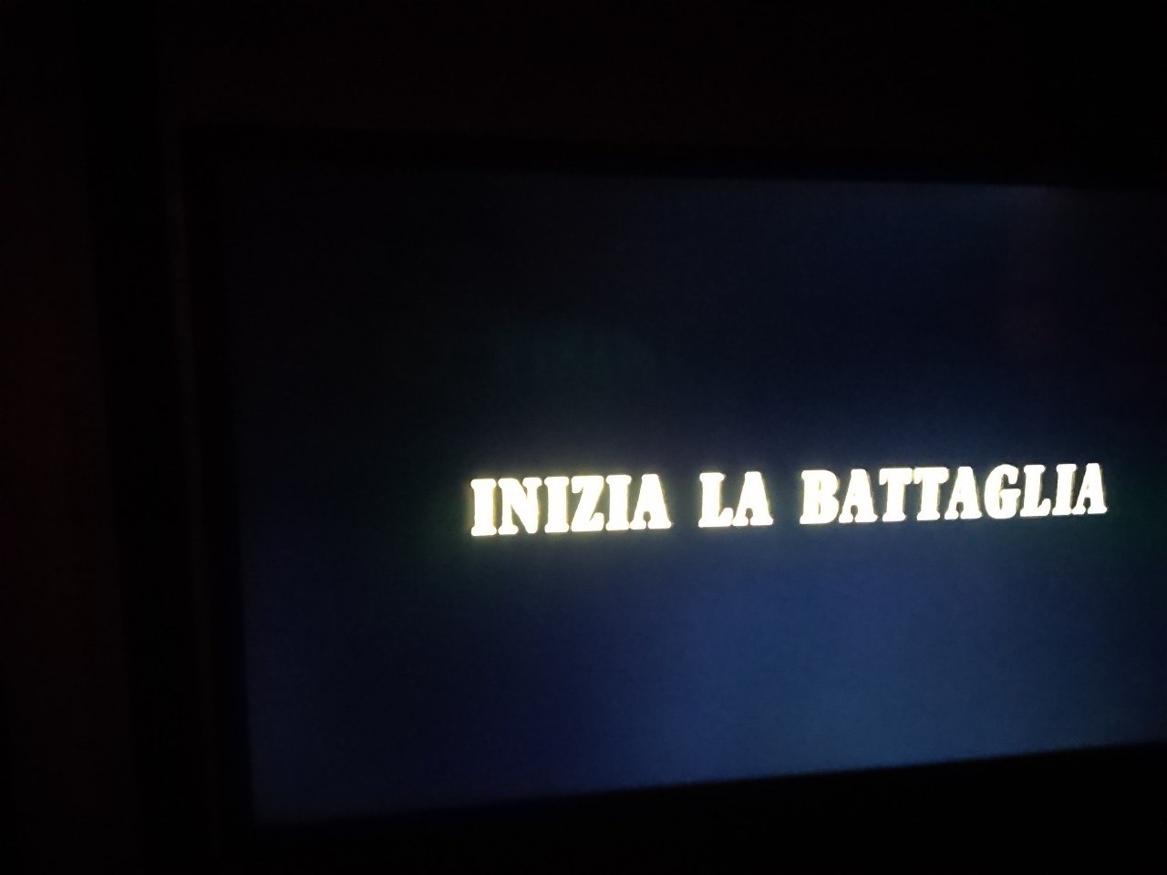

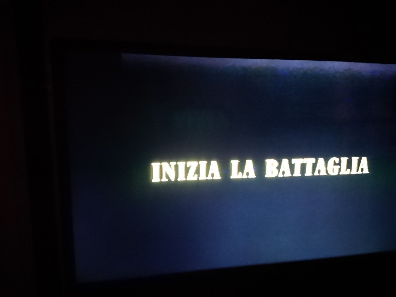

    I have a problema with my JVC HR-S9500. When TBC/NR Is activated, a white gradient appears in the upper side of the image (first photo) . When turned off, it disappears (second photo).
    Has anyone had this problem?
    [Attachment 68669 - Click to enlarge]
    [Attachment 68670 - Click to enlarge]

    In the analog world you have to lower your expectations, Nothing perfect with VHS. The TBC does digitize the video and convert back to analog, that could be the reason, Another one could be aging electronic components, If it's visible only in dark screen don't worry about otherwise send it for a full restoration, Such job could cost around $400.
  3. mr. Eric-jan's Avatar
    Apr 2018
    Netherlands
    My guess it's a bleed through because a TBC removes also MacroVision, which is also is in those upper lines that are not visible in the screen image, is there anywhere an option for upper or under scan ?
    Also a guess is, that the bezel of your tv is just covering a slight edge of the border of the actual lcd screen, so it could be partly "feature" of your tv/monitor also.

  5. It's not the TBC. It is the NR filter which seems to make the picture generally brighter as I see it. But how do we know which one is "correct"?
    Apparently TBC and NR can't be selected independently for this VCR model.
    I need to see actual captures to diagnose, not bad cell phone photos.
    Clips, not still.
    Right now, it could be anything, and all guesses thus far as just random guesses.
  7. Thanks for helping.
    While waiting to make some captures, I am attaching some videos that may help. It seems that the VHS is normally darker in the upper and bottom part and the TBC/NR corrects the problem, but I don't understand why it's so bright in the TV which I took the picture from.
