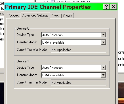

  7. ½ way to Rigel 7 cornemuse's Avatar
    Mar 2014
    Cyber Dystopia
    [Attachment 68677 - Click to enlarge]
    If I click on transfer mode, the option is *DMA if available & *PIO only.
    There are 3 primary, all are the same ^
    -c-

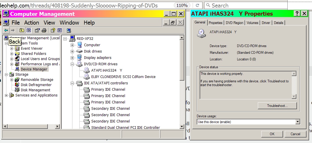

    cornemuse,
    Are you using Windows XP? Are you using internal or external DVD drives? I assumed internal.
    When you are looking at Device Manager, expand (click the + before) DVD/CD-ROM drives. It will show the model of your DVD drive. Right click and select Properties. Under the General tab what does it show under Location?
    Back at Device Manager, when you expand IDE ATA/ATAPI controllers you mentioned there are 3 Primary Channels. Are any Secondary IDE Channels shown? Typically, a PC would have a hard drive cabled to the Primary IDE Channel and the DVD drive would be cabled to the Secondary IDE Channel to maximize data throughput.
    For what it's worth, when your problem has happened to me, I have uninstalled the driver (the Second Method in the previously linked article) for the Secondary IDE Channel since my DVD drive was cabled to the Secondary IDE Channel. Upon reboot, the driver was automatically reinstalled and showed Current Transfer Mode: Ultra DMA Mode 5 under Device Manager > IDE ATA/ATAPI controllers > Secondary IDE Channel. After that fast DVD reading was restored.

  12. ½ way to Rigel 7 cornemuse's Avatar
    Mar 2014
    Cyber Dystopia
    XP yes
    [Attachment 68707 - Click to enlarge]
    Shows the correct cdrom drive, second one is software drive from slysoft

    Sep 2006
    cornemuse,
    Since you show Location 0 (0) for your DVD drive, I would have thought the DVD drive was cabled to the Primary IDE Channel and set as Master (Device 0).
    Yet per your previous picture, your Primary IDE Channel Properties > Advanced Settings > shows Current Transfer Mode: Not Applicable. "There are 3 primary, all are the same ^". I would expect that result if no hardware is physically connected to the Primary IDE motherboard connector.
    Did you check the Properties > Advanced Settings of the Secondary IDE Channels? Are any of the 3 Secondary IDE Channels showing Current Transfer Mode: PIO?
    I'm at a loss on how to proceed checking DMA verses PIO transfer mode for your DVD drive based on the discrepancies.
