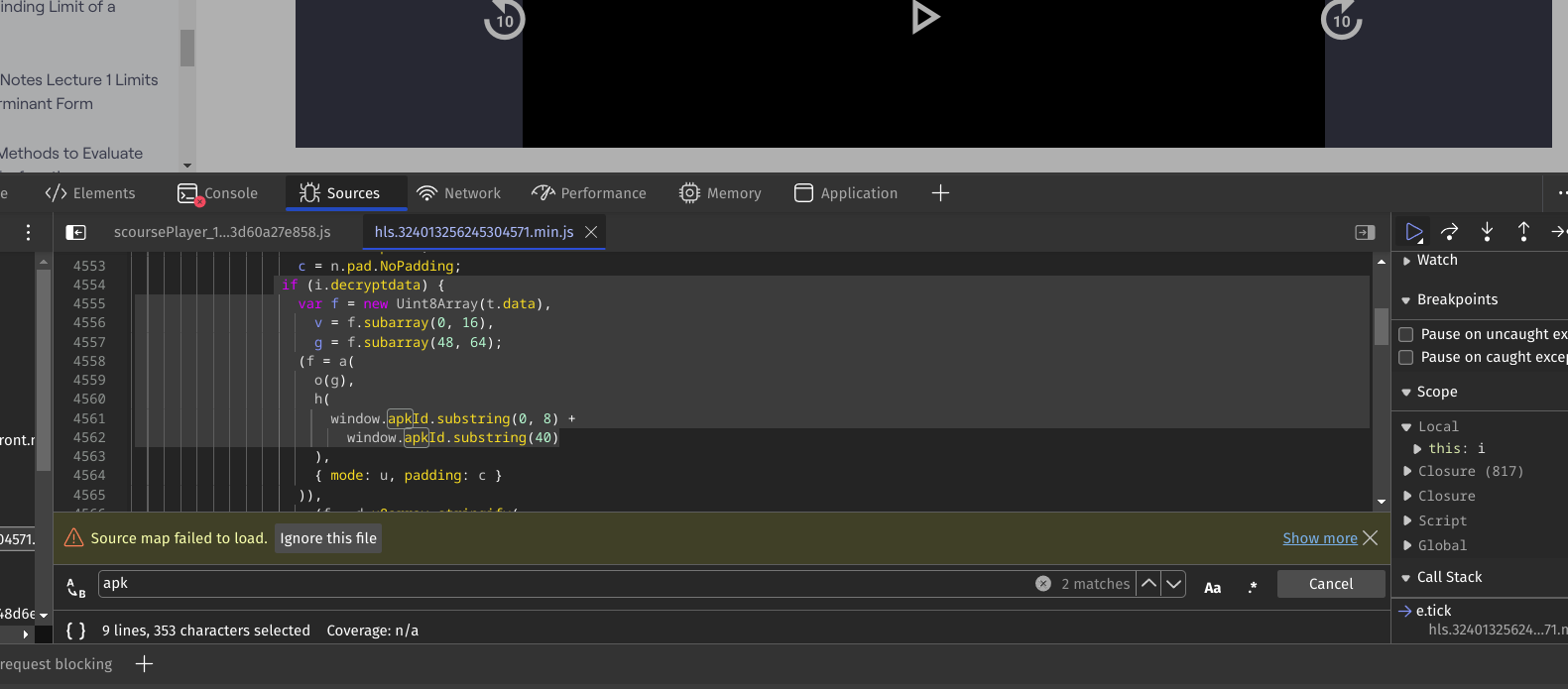

if (i.decryptdata) { var f = new Uint8Array(t.data), v = f.subarray(0, 16), g = f.subarray(48, 64); (f = a( o(g), h( window.apkId.substring(0, 8) + window.apkId.substring(40)
[Attachment 79573 - Click to enlarge] apkidCode:6634623566346235346361623265353961633064346361623265353961633064
