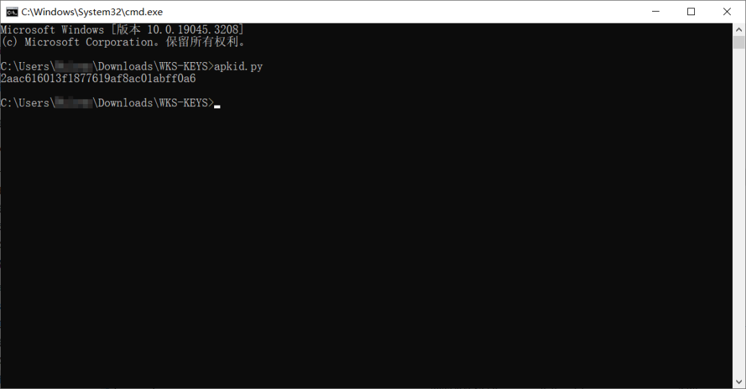

    @swappyison Use this:
    import binascii
    from Crypto.Cipher import AES
    with open("timestamp", "rb") as file:
        data = file.read()
    apkid = '62313734323630386634656538646135'
    def _decrypt_key(data, apkid):
        tmp1 = data[0:16]
        tmp2 = data[32:48]
        dec1 = AES.new(bytes.fromhex(apkid),AES.MODE_ECB)
        tmp3 = dec1.decrypt(tmp1)
        dec2 = AES.new(tmp3,AES.MODE_ECB)
        return dec2.decrypt(tmp2)
    result = _decrypt_key(data, apkid)
    hex_result = binascii.hexlify(result)
    print(hex_result.decode())
    To make this script run, please download the key file timestamp in advance, then put timestamp and this script in the same folder.
    Then run this script in the CMD window. In the screenshot below, I renamed it as "apkid.py", the result will be very clean, it's just the key to decrypt the video and the audio.
    [Attachment 72888 - Click to enlarge]
    Be aware that you can make this line
    into this one
    apkid = input('\napkid: ')
    if you are trying to download other episodes.

    Originally Posted by swappyison View Post
    sorry i had typed this, ./N_m3u8DL-RE -M format=mp4 --key 2aac616013f1877619af8ac01abff0a6 "https://d2qny97nu4rj64.cloudfront.net/spees/w/o/6197321b0cf23d7cc6e572e1/v/6337f80fe4b05a534f0e3d5a/u/pu/t/87bb35a36b01e0943ef12fa4e6f5ef7c/p/assets/videos/6197321b0cf23d7cc6e572e1/2022/10/01/6337f80fe4b05a534f0e3d5a/index.m3u8" --save-name ge.mp4
    and the same error
    The secret key used by N_m3u8DL-RE is kid:key
  28. i am so sorry, could you please suggest me the corrected command.
    thanks in advance
  29. Member piaohua's Avatar
    May 2023
    中国
    thanks in advance
    --custom-hls-key 2aac616013f1877619af8ac01abff0a6
  30. thank you so much! Have a great day ahead!
