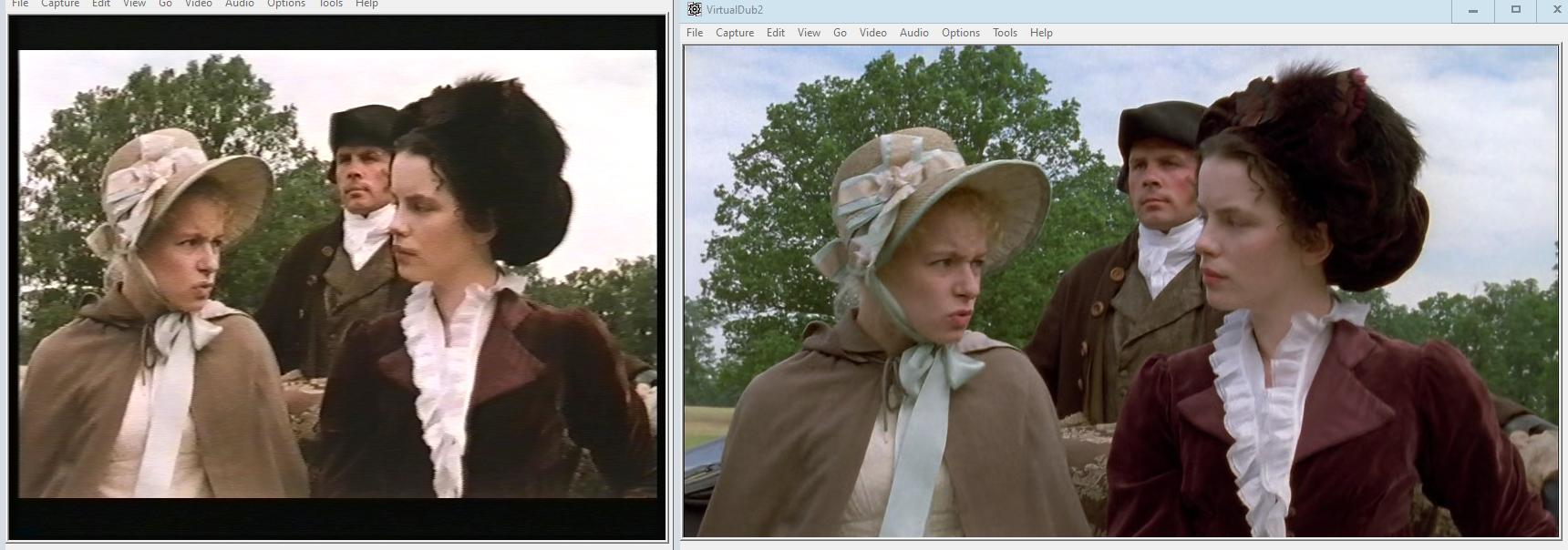

  12. One 16:9 version I saw has a little more of the frame horizontally, a little less vertically.
    [Attachment 68624 - Click to enlarge]
    That's the OP's video on the left, a 1080p version (scaled down to 540p) on the right. Both are square pixel here so the OP's video is narrower (720x576) than it should be displayed when accounting for the SAR (~786x576).

    Thanks very much all, I've finally found the trailer on IMDB (couldn't see it for the life of me yesterday) and overlaid the two videos to match them: as best I can tell, the VHS frame comes out at 1.53:1, so 14:9/1.55:1 it is.
