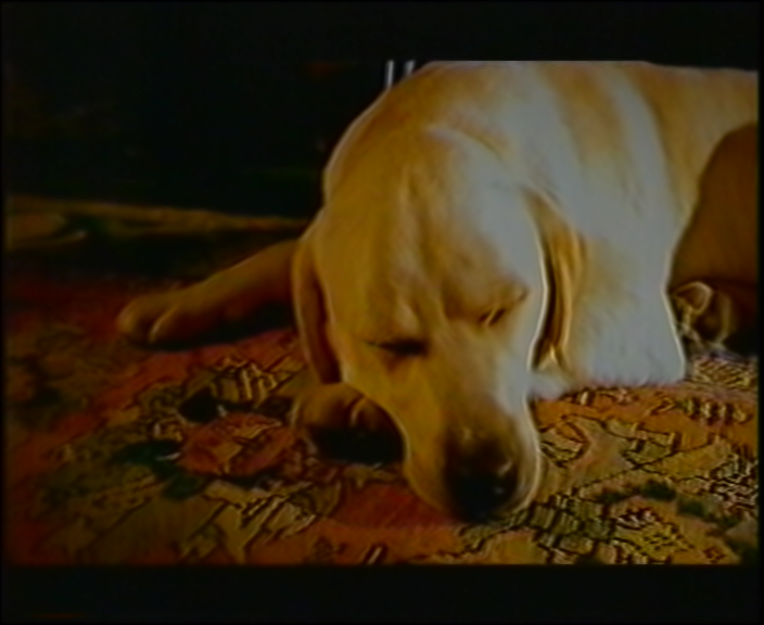

I've encountered a few recordings with a very static picture due to the use of an indoor aerial, and would like to clean things up a bit. I've just attached a short random example.
I've tried SMDegrain, and whilst it helps a little, there's still too much noise.
				Results 1 to 8 of 8
	Code:AVISource("Aerial Noise.avi") converttoYV12() knlmeansCL(d=10,s=8,h=10.0) smdegrain(tr=6,thsad=1000) knlmeansCL(d=10,s=8,h=10.0)
 [Attachment 68585 - Click to enlarge]
 But I would rather ditch this capture.
	Getting a 'There is no function named 'knlmeansCL' error, despite having put the 64-bit plugin in the correct folder.
 Impressive results. I will be ditching this capture, it's just a random snippet of no value.

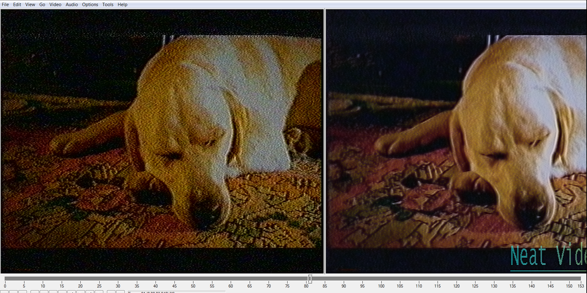

	Neat was made for this kind of noise
 [Attachment 68587 - Click to enlarge]*** DIGITIZING VHS / ANALOG VIDEOS SINCE 2001**** GEAR: JVC HR-S7700MS, TOSHIBA V733EF AND MORE
	Thanks, i got the 64-bit plugin to work eventually. Yes i am deinterlacing all my clips anyway, so always apply after deinterlace for best results.
 Wow that's even better. I wish i knew how to use Neat properly. So from what i gather, Neat works by fetching information from the previous and following 5 frames to reconstruct a better image? And can Neat do so whilst retaining detail and not let it be smeary? And does it work better on longer sources?
	Neat looks nice. (Using HQ3D (or BM3D) with high strength + SMDegrain + DeSpot/Lossless + some sharpening returns similar results here)
 But I agree that proper recapturing would be the preferred approach.Last edited by Selur; 8th Jan 2023 at 06:25. users currently on my ignore list: deadrats, Stears555, marcorocchini
	I find the trick is to use an area of constant colour. In this case, I used the blue sky at frame 18 after deinterlacing with VDub's deinterlacer.I wish i knew how to use Neat properly.
 You can also play around with the sliders to set the desired amount of NR; back it off if it's too plasticy.
