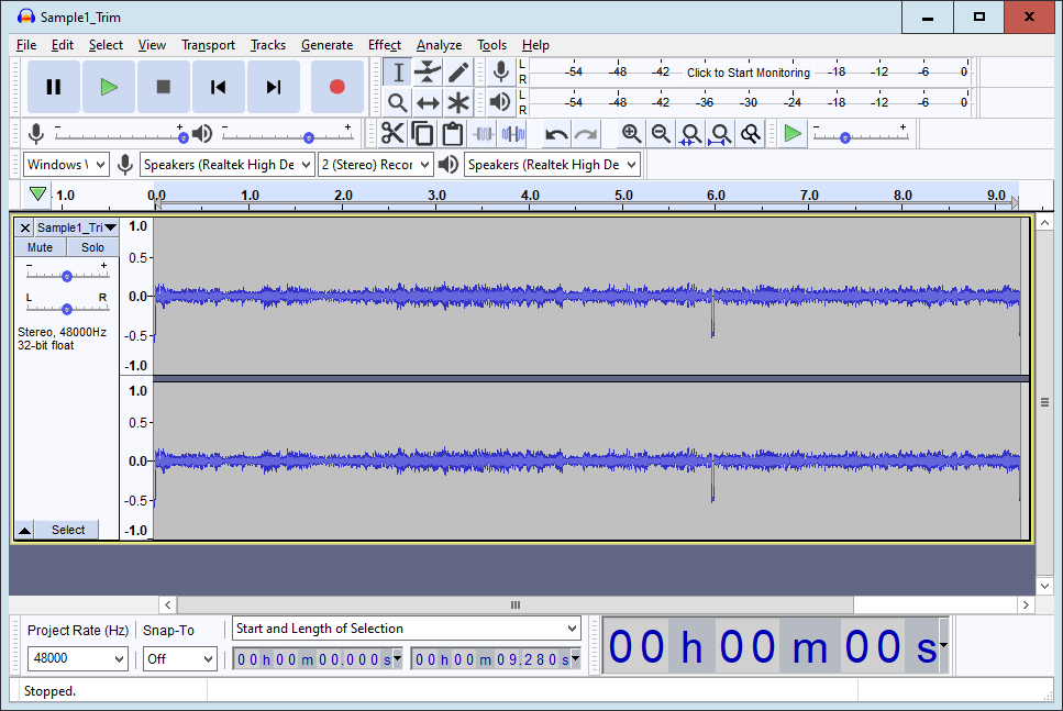

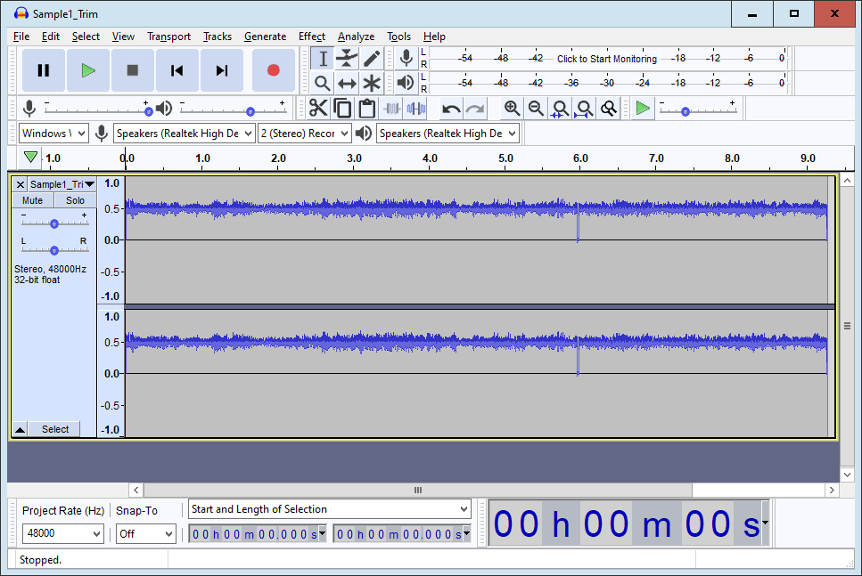

  10. I think there's some kind of grounding problem in your capture setup. The audio has a large DC offset in the audio:
    [Attachment 68591 - Click to enlarge]
    It should be centered around 0.0, not 0.5:
    [Attachment 68592 - Click to enlarge]
    The pop (about 2/3 the way through the sample here) may be something in the system reacting to that offset.
    thought grounding problem was only AC ?
