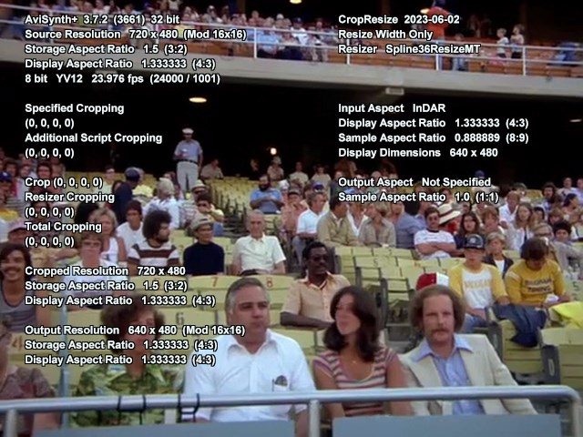

  1. If you're using Avisynth you can see the difference between a 15:11 and 4:3 DAR using the CropResize script in my signature. It'll also display the corresponding input sample/pixel aspect ratios (obviously different for PAL and NTSC).
    The script is being told to resize the width only (open the images in their own tabs for a full size version).
    For a 4:3 DAR, the script can just resize to 4:3 dimensions (obviously).
    CropResize(InDAR=4.0/3.0, ResizeWO=true, Info=true)
    [Attachment 71755 - Click to enlarge]

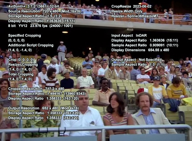

    For 15:11 the width ends up a little wider, although the script has also cropped a couple of pixels so as to resize to mod4 dimensions without aspect error (652x480). It calculates the resizing and cropping based on any input DAR you tell it to use though, so cropping and resizing without aspect error means "according to the specified input DAR".
    CropResize(InDAR=15.0/11.0, ResizeWO=true, Info=true)
    [Attachment 71756 - Click to enlarge]
