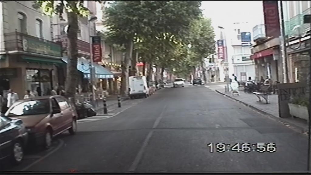

    I transferred several MiniDV tapes (PAL, SD) to my PC. The video files's specs are: 720x576, 1:33:1, 25fps, 25Mbit, interlaced.
    I wanted to convert them to 768x576, 1:42:1, 50fps, 12Mbit, progressive.
    Should I use Topaz Video Ai or are there settings within Handbrake or AviDemux, etc. that would do a similar job just faster? Would love to hear your ideas because
    Topaz (often) brings great results, but takes far too long (1fps working speed).
    People ask me why I don't leave the files as is and watch the originals without further converting.
    Playing these interlaced 25fps videos looks bad (VLC, Potplayer, MPC, etc.) - Is this only happening to me? Shouldn't one convert those videos for the framerate, for the aspect ratio, for the resolution?
    Am I wrong when I say that 720x576 isn't the correct aspect when watching a 4:3 video? When I watch one of these 720 videos the picture is squeezed. When converted to 768 the picture looks fine (same as on the preview screen on my camera). This correct video is in 1:42:1 aspect. So when you look at my screenshot of my 3 different results (Topaz) I assume that the aspect is maybe something to look into. Again, maybe I am on a wrong track here. But look for yourselves.

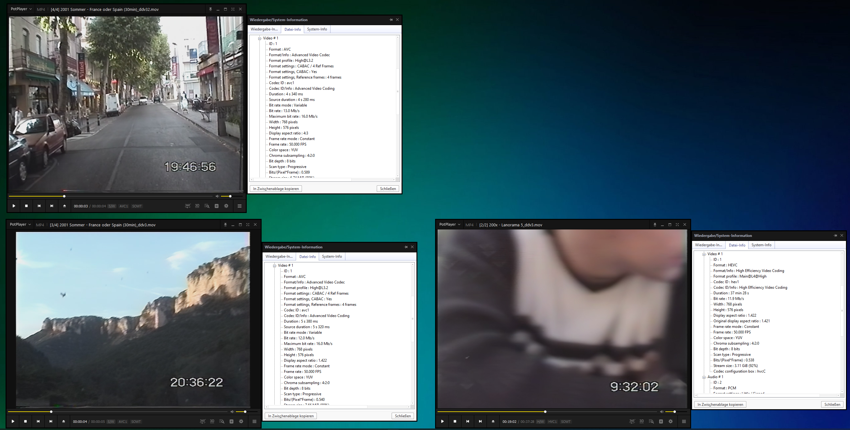

    [Attachment 68564 - Click to enlarge]

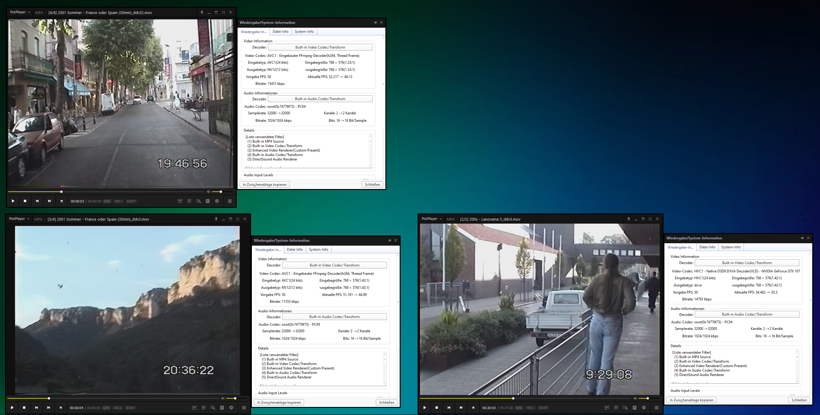

    [Attachment 68565 - Click to enlarge]
    The first example shows a video with the aspect of 1:33:1, squeezed picture. The second example shows 1:42:1, but instead of stretching the picture to the correct aspect, it I got black borders at the sides (in Topaz I checked "Original Pixeltype" and "Letterbox/Pillarbox". The third example shows (in my opinion) the correct aspect ratio, 1:42:1 without the artificial borders (sorry for the german interface).
    How should I proceed? What would you do to get the best quality out of these little SD videos? And am I doing/thinking something wrong here?

  2. The image at the top left looks to me like it should be closer to 16:9, not 4:3 or 1.42:1. I cropped the frame down to 704x576 and resized to 1024x576:
    [Attachment 68566 - Click to enlarge]
    For me, it's too stretched out. The numbers should be square.
    But these recordings don't look like miniDV tapes -- usually there is no such noise at the bottom of the picture...
