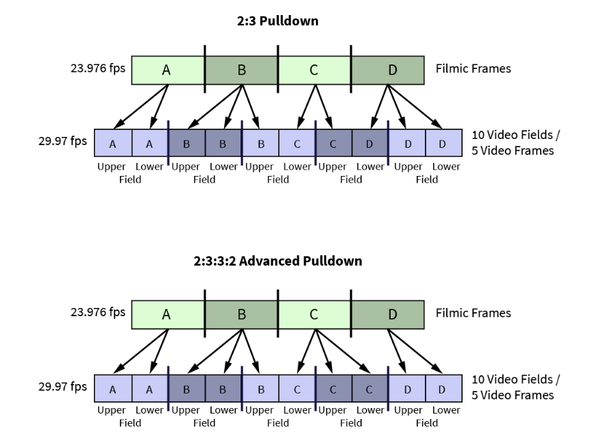

  6. Originally Posted by Bwaak View Post
    The HV40 has two modes: 24F and 24P, one is 2:3, another is handled by most software as native 24 fps, but I guess it is the same 2:3 with flags.
    AFAIK 24P and 24PA are synonyms for pulldown, 24P for 2:3 and 24PA for 2:3:3:2 aka "Advanced Pulldown". I don't know what 24F stands for. Maybe it's 24Frame in interlaced PsF (2:2 pulldown) format?. The acronyms are often brand specific and not very clear.
    24PA aka 2:3:3:2 pulldown is "usual" for DV (SD DV), while 2:3 pulldown is generally more common outside of SD DV (film broadcast in NTSC, film on NTSC DVD) as it minimizes judder.
    [Attachment 68567 - Click to enlarge]
