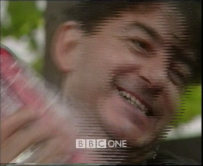

I've had this happen a few times. I think maybe because i left the preview on whilst capturing?
Is there anyway to get rid of this in post, like for videos i no longer have?
Here's an example.
[Attachment 68534 - Click to enlarge]
I've also attached a video to show how it looks in motion.

No idea where this comes from. Maybe a sync problem during capture.
Postprocessing? If it's only for few frames one could heavily blur the artifact section vertically and leave the rest alone.
Code:AVISource("Combing Artifact.avi") v=last a=v.trim(0,83) b=v.trim(84,101).bilinearresize(704,40).bilinearresize(704,576).GaussianBlur(20) #adjust to taste c=v.trim(102,0) vid=a+b+c return vidLast edited by Sharc; 4th Jan 2023 at 03:20.
Having video preview on should not create such an artifact.
But something is not what one should expect from a raw capture. Have you done some filtering/output adjustment during the capture process ? 704*576 is not typical (it should be 720*576) and bitrate is much higher than my own huffy's. Although the video is flagged as interlaced, any chance that it was filtered as progressive ? -

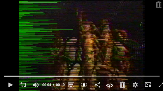

It looks like a TBC processing artifact, similar to the example 1 here:
https://www.avartifactatlas.com/artifacts/tbc_processing_artifact.html
The problem would therefore be with the VCR or other TBC device rather than VirtualDub.
They give also some hints how to fix/prevent it.
[Attachment 68550 - Click to enlarge]Last edited by Sharc; 4th Jan 2023 at 11:14.
Thanks, you may well be right. I thought the heads were going on my VCR as there was a weird flicker at the top of the screen, but turning off the TBC removed it. I'll use my Panasonic ES10 in the meantime.
