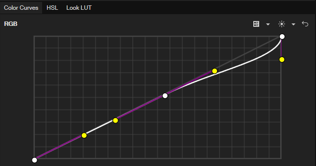

quick way to sort it, to have more detail in blown up whites, this is what our camcorders do,
there is a regular Curves FX effect or tools/Video/Color grading with curves as well

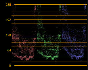

before:
[Attachment 68495 - Click to enlarge]

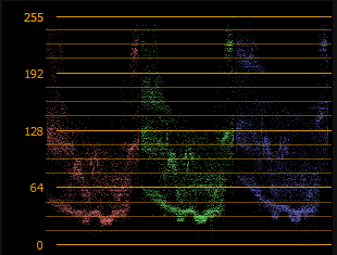

after:
[Attachment 68497 - Click to enlarge]Last edited by _Al_; 2nd Jan 2023 at 19:51.
