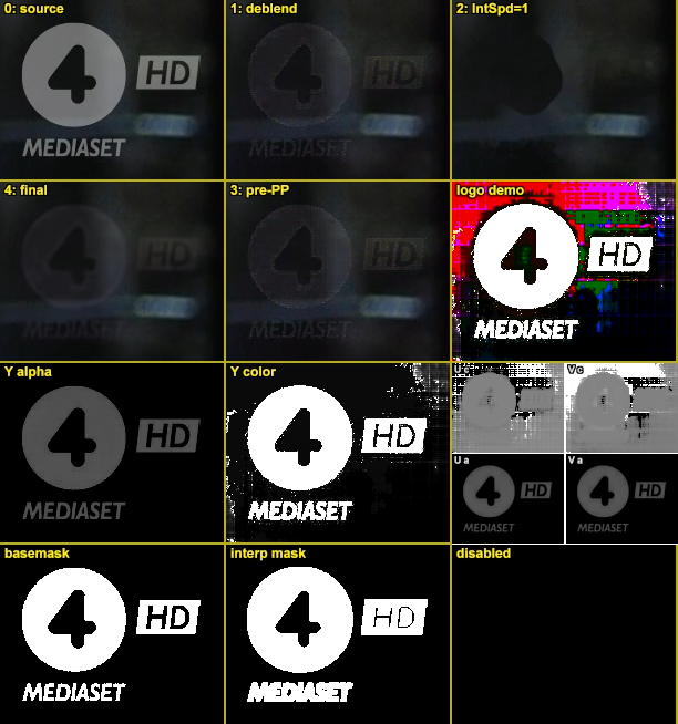

Here is Show=2 from your shared masks [frame 3740 when used Trim mentioned above]:

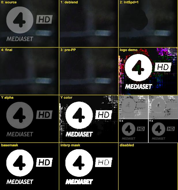

Here it's from my first try [frame 3740 too, but I've used a lil bit different Loc]:

Looks like Analyze=3 creates best deblending masks for this video, looks pretty good for me.
On the black frames there is hardly visible blueish remnant, you can run different parameters on them with some conditional filter.
