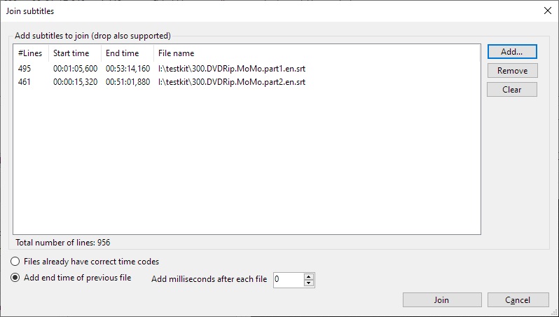

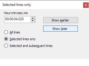

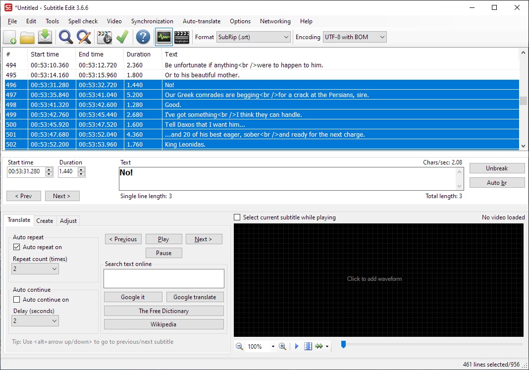

    I wrote this out and created some screen shots about two weeks ago but never posted it. Here it is, perhaps it will help somebody:
    In SubtitleEdit, use tools/join subtitles
    Check the running time of the first movie part to the nearest second. Assume it's 53:20.
    The original second SRT has its first line at approx 15.3 seconds.
    This means in the combined file the first line belonging to SRT 2 should start at 15.3 seconds + 53:20 giving 53:35.3
    The first SRT has 495 lines. So in the joined window lines 496 to the end need to be adjusted.
    Highligh 496 to the end then use synchronization/adjust all times
    when I tried it, I had to add just over 4 seconds to these lines to make it right. (assuming the hyperthetical
    running time I mentioned)
    It takes patience, you'll have to try it and if necessary tweak those lines again, probably in fractions of a second
