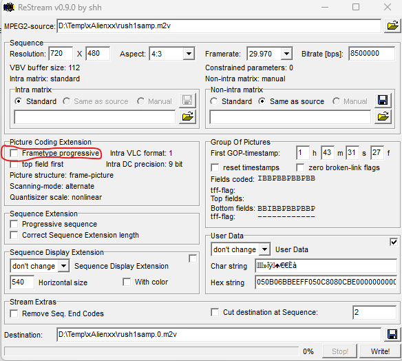

  20. The issue can also be solved by changing the Picture Coding Extension flag of the rush1samp.mpg source from progressive to interlaced. This can be done with the ReStream for example (maybe it can be done with ffmpeg as well?). MediaInfo then reports the Scan type as Interlaced rather than Progressive, and everything behaves as expected.
    Edit: Not quite ..... Both interlaced interviews are ok, but it fails with the telecined section which becomes 2:2 instead of 2:3 (-> audio desync)
