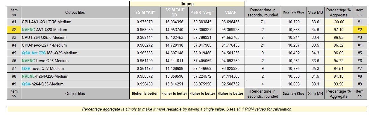

    Jun 2022
    Dublin
    Item no. Output files SSIM "All" SSIM "All" DB PSNR "Avg." VMAF Render Data rate Size MB Percentage %
    time Aggregate
    #1 Source-[CPU-AV1-Q31-'PR6 Medium'] 0.975079 16.034356 39.383845 96.696485 71s 10,720 33.6 100.00% #1
    #2 Source-[NVENC-AV1-Q28-Medium] 0.968039 14.953740 38.300827 95.369925 2s 10,568 34.6 97.10% #2
    #3 Source-[CPU-h264-Q25.6-Medium] 0.969114 15.102453 37.788991 94.553763 7s 10,214 33.4 96.83% #3
    #4 Source-[CPU-hevc-Q27.1-Medium] 0.966272 14.720118 37.947905 94.776435 24s 10,237 33.5 96.32% #4
    #5 Source-[NVENC-hevc-Q26-Medium]s 0.961199 14.111611 37.405059 94.098759 2s 10,261 33.6 94.72% #5
    #6 Source-[QSV-hevc-Q27-Medium] 0.961173 14.108698 37.146669 93.929920 9s 10,795 35.3 94.51% #6
    #7 Source-[NVENC-h264-Q26-Medium] 0.958872 13.858596 37.224572 94.114368 2s 10,550 34.5 94.15% #7
    #8 Source-[QSV-h264-Q33-Medium] 0.958450 13.814251 36.975956 92.508732 4s 10,093 33.1 93.50% #8

    I updated my previous post with AV1 Nvenc HW encoding comparison. I would much prefer to post an image, say jpg, I cannot see how to do it. Ok, managed it.
    [Attachment 72378 - Click to enlarge]
    No B frames were used/harmed in any way.

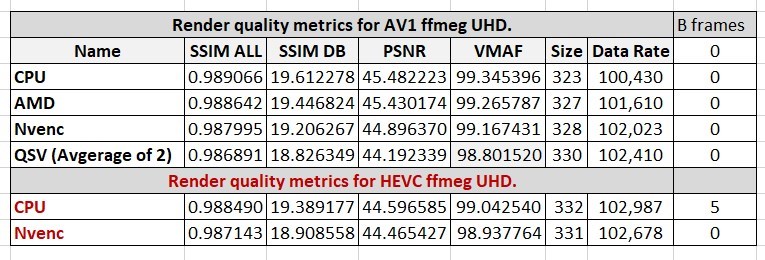

    I couldn't include a FHD AMD comparison as it always outputs 1082 instead of 1080. So I did the AV1 in UHD. Hevc comparison also included for CPU and Nvenc encoding.
    [Attachment 73622 - Click to enlarge]
