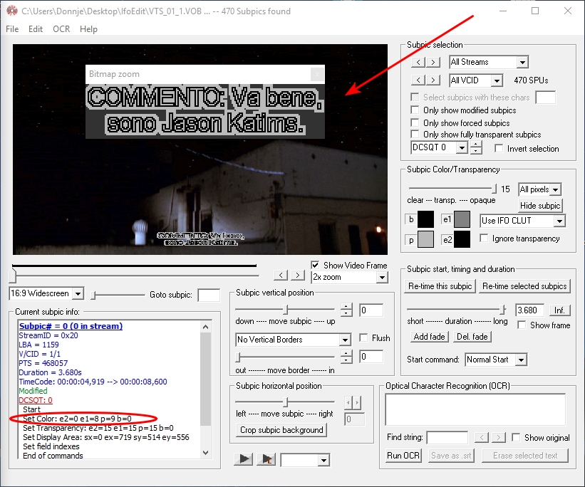

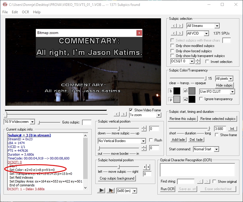

Hi,
In the first screen the color of the subs of the original DVD,
[Attachment 68400 - Click to enlarge]
once extracted I translated the subs and I wanted to have the same color so I copied the "Set Color code: e2=0 e1=8 p=9 b=0"
why if it's different?
[Attachment 68401 - Click to enlarge]

The original subpictures use one unique color for:
- background
- outline
- anti-alias
- text
Your own subpictures are lacking the anti-alias one, plus outline and text use the same color. Without knowing more details how you created your subpictures I can only assume that the problem lies there, not in DVDsubedit. -

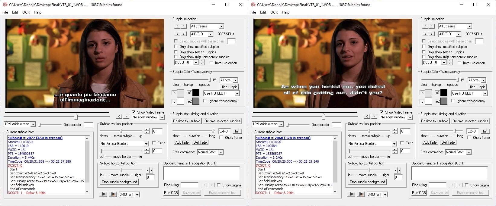

I extracted the .sup from the .VOB and translated it with subtitle edit saving it in .srt and with SubtitleCreator transformed into .sup then with DVDsubedit changed the color code like that of the .VOB
I find an English sub with one color and an Italian one with another I would have liked at least one identical color for both but if I take the the Italian's color code and apply it to all the subs, the English ones are always different

OK, then you just need to re-assign the colors of the English subpictues.
It seems you need to:
assign "e1" to light gray
assign "e2" to black
That should do the trick.
Don't forget to select the English track first in the top right corner (do not leave it on "All Streams").
